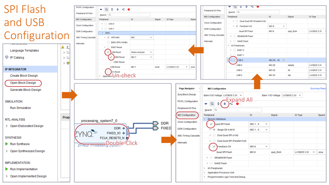

Configuring SPI Flash and USB
After opening up Vivado Design Studio and opening the project created in the last blog post, I moved onto the green area of the design process shown above, and configured SPI Flash and USB peripherals. The steps are in the diagram below if you want to follow along with a MiniZed board.
As can be seen, the main task is merely to enable these peripherals by checking the boxes for them. But there is also some mapping that needs to be done, to bring out the peripheral connections from the processing system out onto real pins on the Zynq chip.
The way the mapping works is described in some comments underneath blog 2. In short, the connections can come out of the processing system and be connected to dedicated pins called MIO (Multiplexed Input/Output). By doing that, the system behaves like any other typical ARM applications processor where one needs to perform some pin mapping based on what peripherals are desired, and what connections are allowed (because the multiplexing hardware and pads on the chip only provides finite combinations). For instance, Texas Instruments calls the process Pin Multiplexing, and the tool for their ARM processor chips has a similar concept, where peripherals can be selected and then the valid pin possibilities can be viewed to select specific pins.
The Zynq chip has some pins dedicated to MIO. But it is also possible to internally divert the connections to an area known as EMIO (Extended Multiplexed I/O) and from there the programmable logic portion of the chip can connect to it, or interconnections can be made to pins as available to the programmable logic.

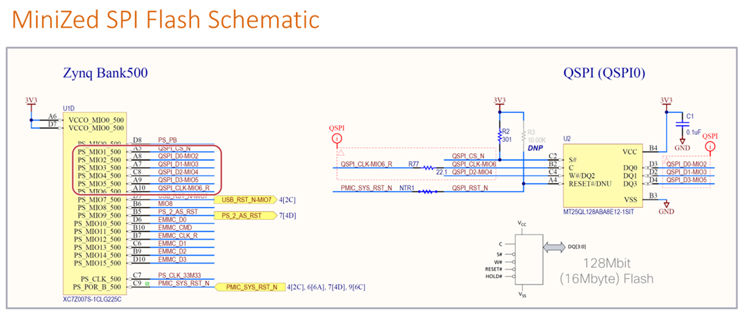

The information to figure out which pins are available for which peripherals, and where these pins physically are located on the Zynq BGA package, and where they are wired to on the MiniZed board, is all described in the comments section in blog 2.

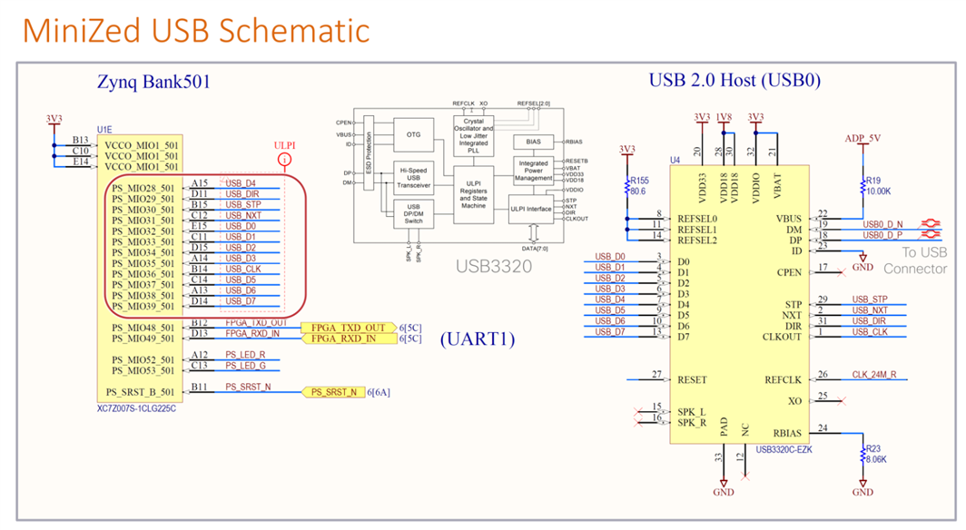

The settings in the screenshot above, show SPI Flash is mapped to pins MIO 1..6 and MIO 8, and USB is mapped to MIO 28..39.
These pins can be verified in the MiniZed schematic – MIO8 is part of the boot mode selection (and it pulled down), and is not shown in this snippet from the full MiniZed schematic:
The SPI Flash chip offers 128Mbit of NOR Flash storage, and it could be used for booting the Zynq chip if desired.
The USB schematic (based on USB3320 chip) is shown below.

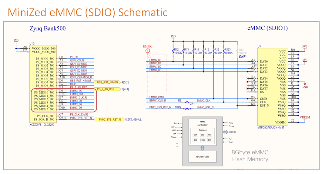

Configuring eMMC (SDIO)
A few more clicks enabled the larger 8Gbyte Flash memory eMMC chip on the MiniZed board. It has an SDIO interface. This memory could be used to store the operating system and application software if desired. The schematic shows the relevant MIO pins:
The first step in the screenshots below shows how to enable the SDIO capability and the pin mapping. The clock detail is described next.

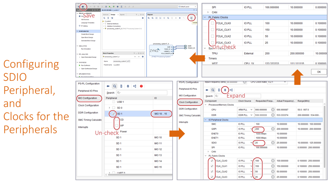

Configuring Clocks for Peripherals
Most chips that interface to the Zynq will have data buses synchronised with a clock pin. Different devices have different clock requirements. In blog 2, the processor system inside the Zynq chip was configured to run at a particular speed, and the external DDR memory clock was configured too, to have a minimal functioning system. Since more peripherals are now configured in this blog post, the clocks for them need configuring too. The steps to do that for the SPI and SDIO interfaces (used for the 128Mbit NOR Flash, and the 8Gbyte eMMC Flash respectively) are configured as shown in a couple of the screenshots above.
The SPI interface can be clocked to beyond 100MHz for the particular memory chip that is used on the MiniZed board, but the configuration is set to 200MHz because according to the PDF Zynq-7000 SoC Technical Reference Manual UG585 (in section 12.4.1), the clock is divided internally by a configurable value of at least 2 (the precise divider setting is set in a register, as part of the software board support package that is created using the Xilinx SDK just prior to writing the application code).
The SDIO speed is set to 25MHz, because the eMMC chip supports up to 26MHz in one mode (it also supports 52MHz, but I don’t know enough to be sure if that clock speed would work).
Some processor logic (PL) fabric clocks were also set, but disabled, and more about these will be explored in later labs – they are currently unused for the purposes of this blog post.

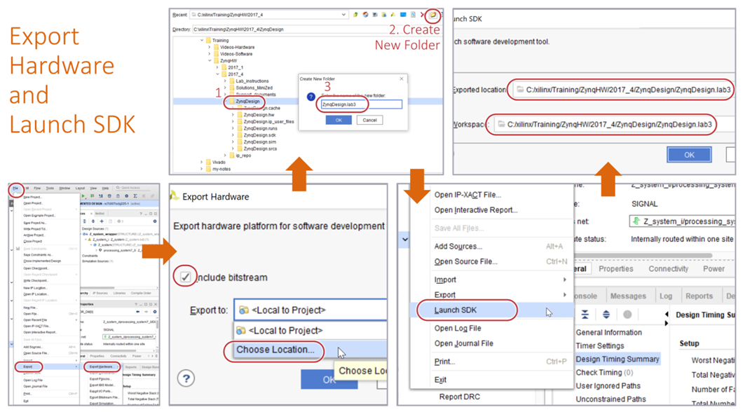

Export Hardware and Launch the Xilinx SDK
These are the last couple of stages before the software developer can start working on the project. The steps are very similar to those in Blog 2, except that this time a new folder is created for the files to be exported into, and the software development environment (Xilinx SDK) is invoked to use that folder for the software projects.

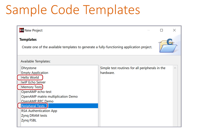

There was no need to type any code to test the memory and peripherals; the Application Project wizard was re-used, only this time instead of selecting Hello World for the sample code in the wizard, Memory Tests or Peripheral Tests was selected. A new project name was given for the code too.

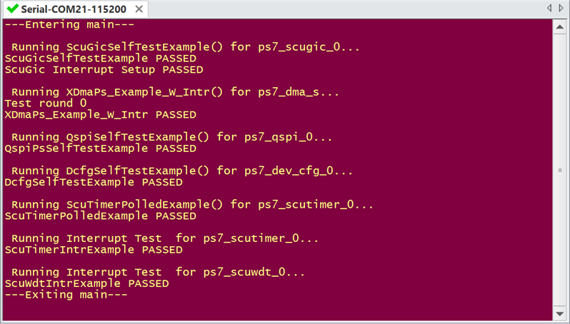

Running Peripheral Tests
The Peripheral Tests code output is shown below:
Much like the memory tests, these peripheral tests also call functions from the BSP in order to perform the tests. For example, the QspiPsSelfTestExample output on the console refers to a test where the SPI peripheral was tested by reading and writing an internal register, to prove that the peripheral was correctly connected and functioning.
These test functions are really important for verifying that a board is functioning correctly. For a real-world scenario, diagnostics code could be written, extended from the sample code. It would do things like exercise the memory and peripherals inside the chip as well as external chips. Such code is handy for many tasks. As one of my first jobs, I had to test mobile phone base-station cards, and create diagnostics capability (not on a Zynq SoC at the time, but on a processor on the board). I used it to run extended diagnostics while the board was temperature-cycled in an oven, to see if/when failures occurred, to reduce failure rates in the field (it’s not always easy to access mobile phone base stations for repair!). In the case of the Zynq, the wizard is doing half the job, creating nice sample code!
