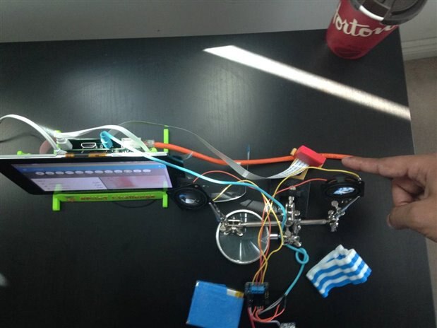

Here is a quick post on integrating camera's with Home Assistant, this includes
  • Pi Camera connected to Raspberry Pi 3 as part of the Hub
  • Security camera that we create using a Raspberry Pi Zero, PI NOIR camera and installing Motion with Single File PHP Gallery in a previous blog post - Pi Control Hub: Spoke 1 :Security Camera

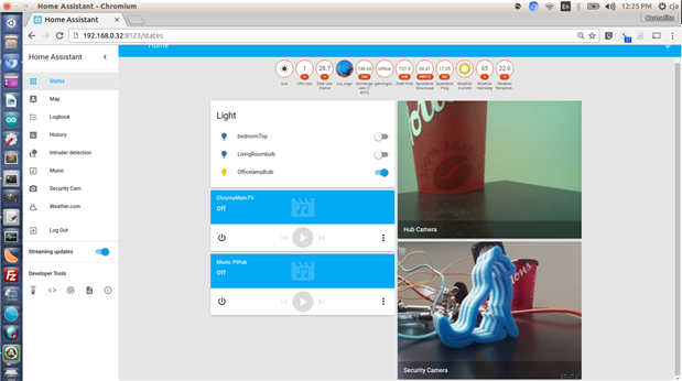

Basically, as part of Home Assistant dashboard we are going to add two sections  showing the preview of Pi Cameras as shown in the pictures below
{gallery} Integrating Camera's in Home Assistant
Home Assistant dashboard with Pi Cameras preview.

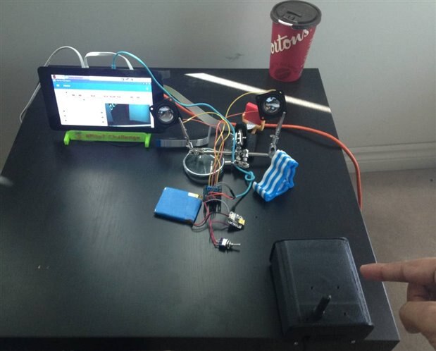

Security Camera setup with Pi Zero + NOIR camera, in a 3D printed case.

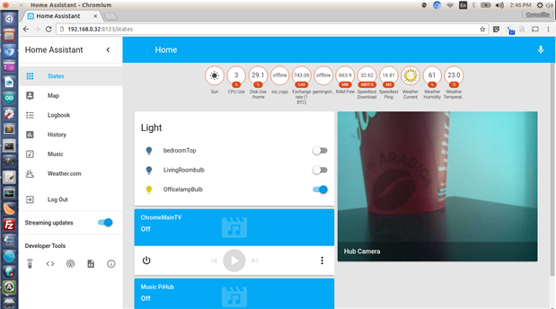

Pi camera connected  to the Raspberry Pi 3

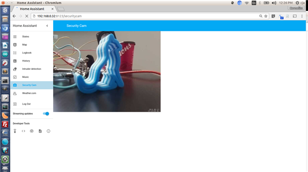

Security camera feed in a  separate tab

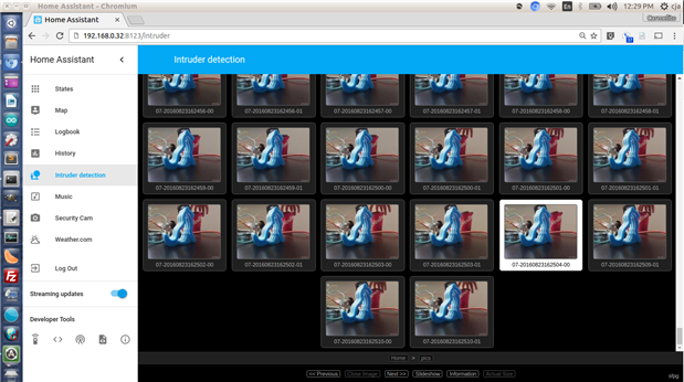

Picture gallery of the intruders detected image , using Single File PHP Gallery
Having a close look into the picture from the Picture gallery

#1  Connect the Pi camera to Raspberry Pi 3 and run the following commands to create a directory called picamera
         pi@hub:~ $ cd /home/hass
         pi@hub:~ $sudo mkdir picamera
         pi@hub:/home/hass $ ls
         picamera
         pi@hub:/home/hass $ sudo chown hass picamera
      and then create a image file
        pi@hub:/home/hass/picamera $   touch image.jpg
#2 Update the configuration.yaml file
camera:
  platform: rpi_camera
  name: Raspberry Pi Camera
  image_width: 640
  image_height: 480
  image_quality: 7
  image_rotation: 0
  timelapse: 1000
  horizontal_flip: 0
  vertical_flip: 0
  file_path: /home/hass/picamera/image.jpg
   and then stop and start Home-Assistant and test
      sudo systemctl stop home-assistant@hass
      sudo systemctl start home-assistant@hass
#3 Adding the Security camera  to the dashboard
    modify the configuration.yaml to include the following under the camera section
- platform: mjpeg
  mjpeg_url: http://192.168.0.21:8081
    change the ip address above with the security camera Pi's ip address

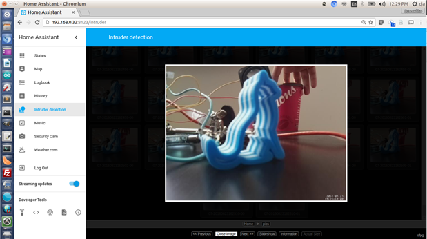

#4 To add Security camera Preview tab and the Intruder detection tab which show the picture gallery
       Add the following under the panel_iframe section of the configuration.yaml file
  intruder:
    title: 'Intruder detection'
    icon: 'mdi:nature-people'
    url: 'http://192.168.0.21/'
  securitycam:
    title: 'Security Cam'
    icon: 'mdi:camera'
    url: 'http://192.168.0.21:8081/'
