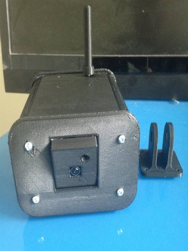

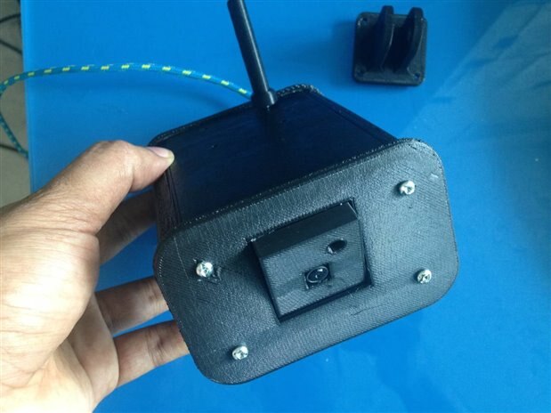

As part of this blog post we will 3D print the STL files attached, to make a case for the Raspberry Pi + Pi camera, which makes it look like a security camera..

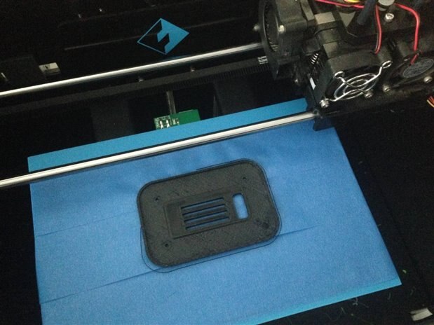

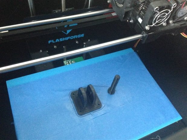

Download the STL files attached in the Zip file below and 3D print the files, here are the slicer setting I used on my Flashforge creator pro
Layer height - 0.3 mm
Infill density - 30%
Temperature - 205 C (i am using Hatchbox Black 1.75mm PLA )
{gallery:width=900,height=400,autoplay=true} Security Camera using Raspberry Pi and Pi Camera
3D printed case for the security camera

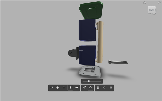

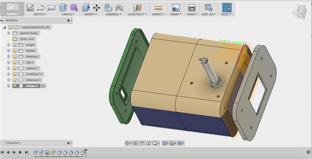

Case design in Fusion 360
Camera case exploded , designed in fusion 360
3D printing the back part of the Security camera case
3D printed Antenna and Base mount
3D printed parts, printed in Black PLA

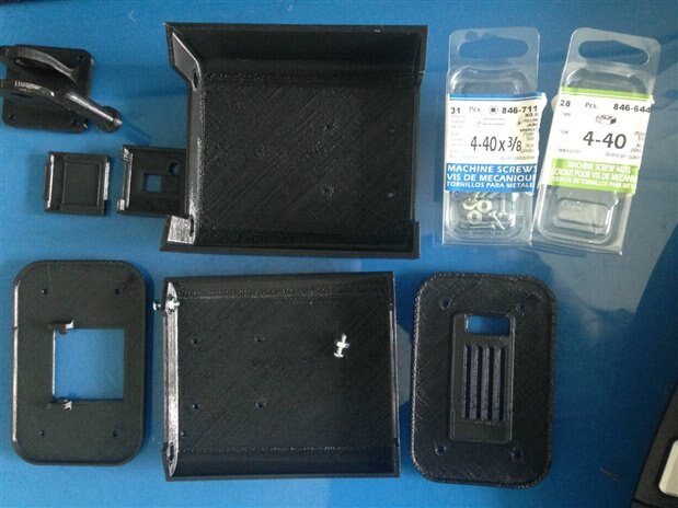

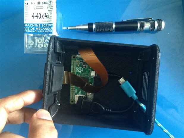

Adding Screw and nuts to the 3D printed parts

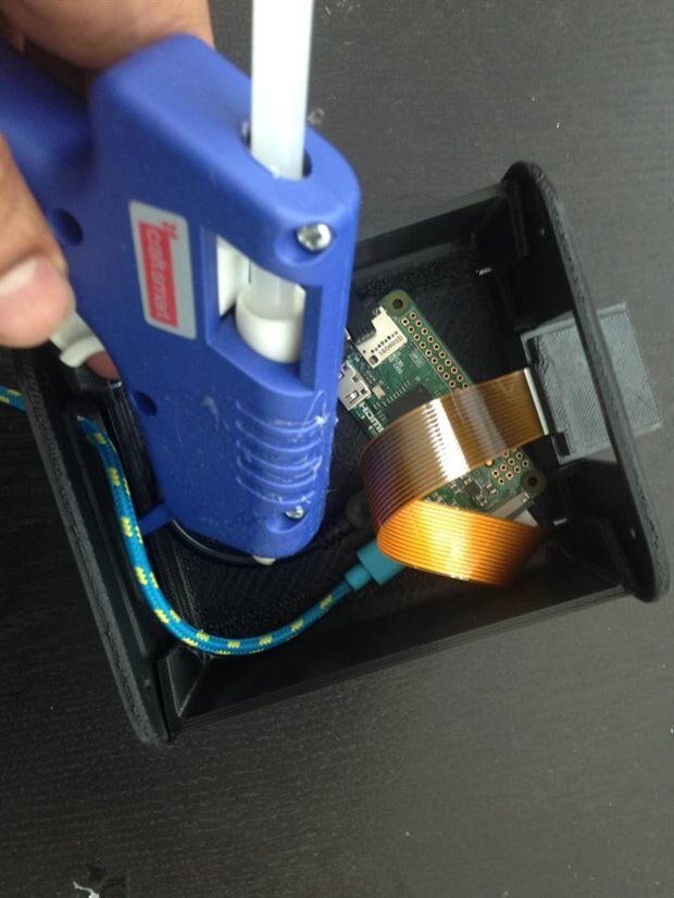

Hot glue'ing the USB cables to the base.
Added the top 3D printed part with the fake Antenna

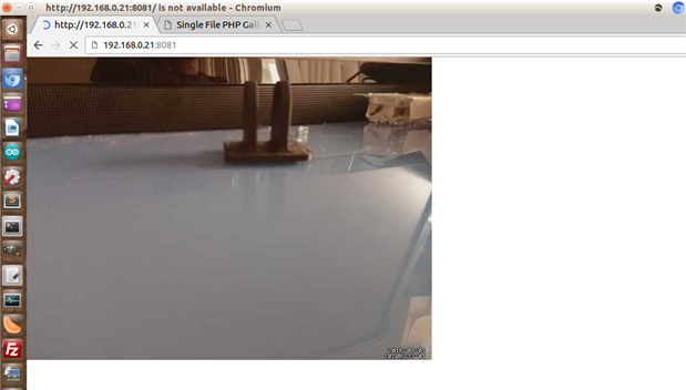

Video stream from Pi Camera at http://IpAddressOfPi:8081

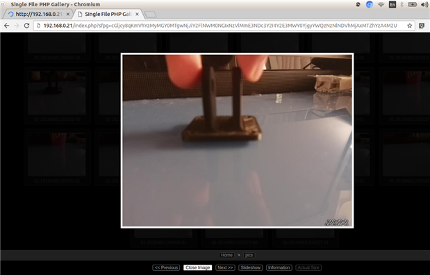

En-larged photo from the Photo gallaery at http://IpAddressOfPi
It took me about 7 hours to 3D print all the files, and the files were designed in Autodesk Fusion 360 as shown in the picture above. While designing the files I considered using the Raspberry Pi model B+ with the Pi camera. And yes, I could have gone even smaller considering that I am using a Pi Zero now  image ..
Once you are done with the 3D printing STLs, use 4-40 x3/8 screws and 4-40 nuts, and hot glue the USB cable that is connected to the power and Wifi USB adapter to hold the components to the base.
