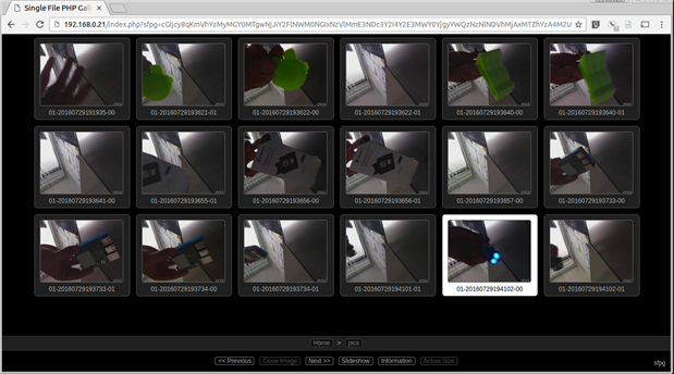

As part of this blog post we will setup a simple web server on the Pi using lighttpd and  Single File PHP Gallery 4.6.1 by Kenny Svalgaard to display images that motion stores when an intruder/movement is detected.(I have used the single file PHP gallery  a couple of years back, when using the original Pi model B and the Pi Camera on a simple bird watching project for the summer and which means I can vouch for it ).  As part of the gallery as shown in the picture below, you can preview all the picture taken when movement is detected and also click on the pictures enlarge and even download the full size image to your laptop, if you have to image..

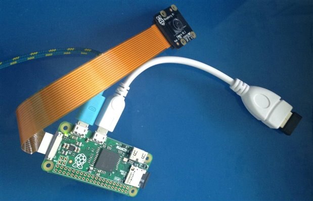

In addition, I am going to move the Pi NoIR cam + SD card + WiFi USB adapter to the Pi Zero as showing in the picture below, because I plan on using the Pi B+ on another spoke.

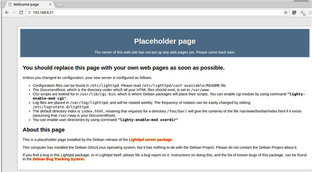

#4 Stop and Start the the lighttpd service and test
       sudo service lighttpd stop
        sudo service lighttpd start
     or you can also use - sudo service lighttpd restart , if everything is setup correctly, when you open your browser to test - http://ipaddressOfPi
In case you come across an error/or the page does not load, check your error logs to debug
     sudo tail /var/log/lighttpd/error.log

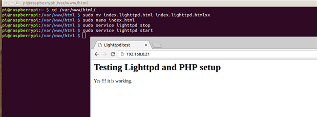

#5 Optionally, if you would like to run a test with a small html page of your own, use the following commands
      cd /var/www/html/
    rename the exist file that serves the page in the screenshot above
       sudo mv index.lighttpd.html index.lighttpd.htmlxx
    create an index.html file
        sudo nano index.html
    Copy paste the following code
<html>
<head>
<title>Lighttpd test</title>
</head>
<body>
<h1>Testing Lighttpd and PHP setup</h1>
<p>Yes !!! it is working.</p>
<p><?php phpinfo();?></p>
</body>
</html>
        ctrl+X to save the file in the nano editor
    Stop and start the lighttpd service

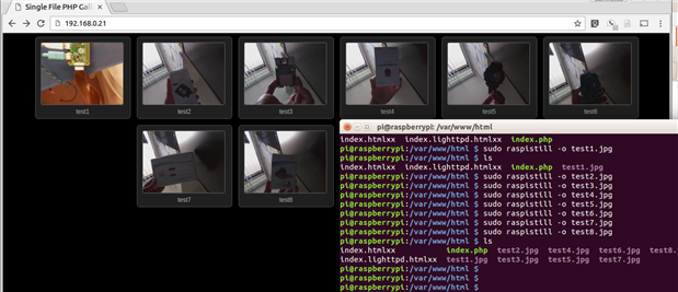

#8 Upload acouple of picture to the html folder or take a couple of pictures using the pi camera
     use a FTP tool like filezilla to upload a couple of images to the /var/www/html
     Or if you dont have an FTP tool navigate to the  /var/www/html folder and take a couple of pictures using
      once done open a URL in the browser http://ipaddressOfPi , where you should see the images you have just taken.

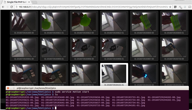

#9 Setting up the motion.conf file to point to the newly create pics folder
     Now create a new folder called pics
       sudo mkdir pics
    Stop the motion service, if you have not done it as part of the previous steps
       sudo service motion stop
   Assign ownership to the target directory for motion
       sudo chown motion /var/www/html/pics
   Now modify the following parameter in the motion.conf file
      sudo nano /etc/motion/motion.conf
    - the target direcotry the new one we created
        target_dir /var/www/html/pics
    - Set a new threshold value to determine when motion is detect, i bumped mine to 3500.You will have to experiment with this value ..Basically Threshold for number of changed pixels in an          image that triggers motion detection (default: 1500).
        threshold 3500
    - And I also choose to have turn off video by setting the ffmpeg_output_movies to off
       ffmpeg_output_movie off
#10 Start motion service and test
         sudo service motion start

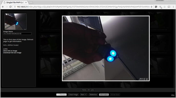

     now when you click on the pics section in the browser  http://ipaddressOfPi , you should see all the images captured by motion , when an intruder is detected
  <in my case i am using random things around me on my table image>, you can also click on the picture enlarge it as shown in the picture below and click the link to download the full size image to your laptop.
And yes, the steam from the pi cam is still available at http://ipaddressOfPi:8081
