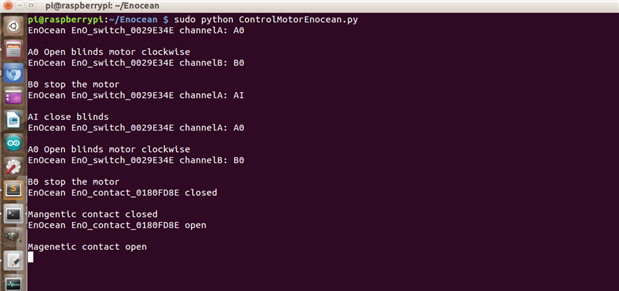

Here is a quick update to the previous blog post in which we setup EnOcean Transervir module and tested PushButton switch(PTM210) ,Magnet Contact Transmitter(STM329) and the Temperature sensor(STM332) with FHEM home automation server(Pi Control Hub:Spoke 2:Blinds Automation-- Setting up EnOcean Sensor and Blinking LEDs ). As part of this post we will drive a gear motor when the PushButton switch is pressed as shown in the video below.Basically the gear motor will help us open and close the blinds.
Also as part of the video, the gear motor turns clockwise when the Magnet Contact Transmitter switch is closed.
In addition to the Raspberry Pi B+ we will also need a motor driver to connect the gear motor the GPIO pins,here I am using SparkFun Motor Driver - Dual TB6612FNG and we will also need a power source , for this I am temporarily using a 4 AA battery pack..

#3 Run the program to test the gear motor as shown in the video above
      Copy paste the code below  to you Pi using nano
         sudo nano ControlMotorEnoceanPi.py
      run the python program using
         sudo python ControlMotorEnoceanPi.py

Here is the output of the program
Here is equivalent output on FHEM's event monitor when the PushButton switch(PTM210) pressed,and the magnet is brought close to Magnet Contact Transmitter(STM329)
