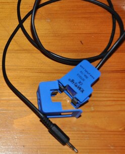

1. The safest way to do this ( not really safe but safer than others I know ) was mentioned to me in a previous post by jc2048 and it refer to the SCT 013-030. More details can be found at 3. AardEnergy – Current and Voltage Transformers . Again, thank you Jon for the advice.
