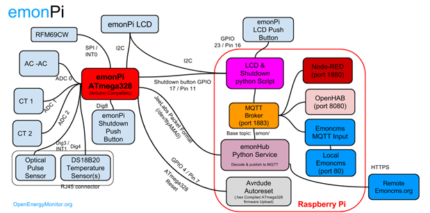

emonPi is an open-hardware energy monitoring solution based on the Raspberry Pi. It was originally launched as a Kickstarter around April last year and raised almost £25,000 with a £15,000 goal. It comes in different flavours, from board only to fully assembled device with custom aluminium enclosure. I have the board only, and will be using it in a combination with a Raspberry Pi Zero rather than the suggested Raspberry Pi 3. The less energy the monitor consumes, the better, right? image

The software side of thing is rather straightforward, as a Raspbian Jessie Lite image with all the emonPi software included is available for download.
The image offers a lot of software preconfigured and activated. Perhaps a little bit too much. That's why I disabled a number of software components and kept a minimum in order to still be able to fetch the actual power measurements, while not unnecessarily exposing unused interfaces.

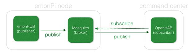

The different, undesired services can be disabled. What it boils down to, is that I'd like to keep the MQTT broker to be able to subscribe to the measurement data, and the emonHub which is doing the actual decoding of the data. The rest is useful when using emonPi as a standalone device, but less so in my case, where all data is gathered to a central point.

The measurement data from emonPi is exposed via MQTT, by default, the following settings apply:

The MQTT setup for my project looks like this:
By configuring the MQTT settings from earlier in OpenHAB and subscribing to the correct topics, the measurements are available on the central control unit.

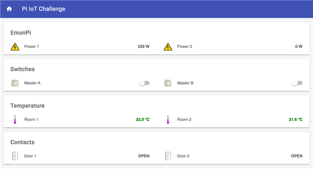

The items are defined to use OpenHAB's MQTT binding, which connects to the configured broker and receives the data from the subscribed topics.
Number  emonpi_ct1      "Power 1 [%d W]" <energy>    { mqtt="<[emonpi:emon/emonpi/power1:state:default]" }
Number  emonpi_ct2      "Power 2 [%d W]" <energy>    { mqtt="<[emonpi:emon/emonpi/power2:state:default]" }
The result is power data from up to two current clamps available on the central interface.
Once persistence will be added, and the data graphed over time, patterns in power consumption will emerge.
