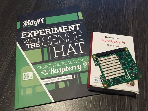

As explained in my unboxing post, I wasn't originally planning to use the Sense HAT in my project. Though the more I read about it, the more I wanted to experiment with it anyway. And since all my other electronics gear is in boxes, waiting for next week's house move, now's the perfect time to see what this HAT has to offer!image
Sense HAT
The Sense HAT, is as the name implies, loaded with sensors. In this paragraph I'll cover which sensors are available and how to fetch their data using the Python reference API. The HAT also has display capabilities using LEDs and input using a joystick.

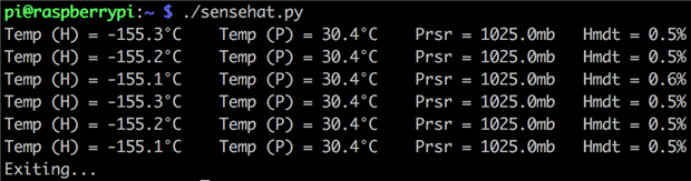

The Sense HAT has a lot of sensors on board. Let's see how to retrieve this data
Temperature, Humidity & Pressure
By default, the temperature is retrieved from the humidity sensor. It is however possible to retrieve it from the pressure sensor instead.
The example below illustrates how to retrieve the data from the humidity and pressor sensor:
#!/usr/bin/env python
# -*- coding: utf-8 -*-
from sense_hat import SenseHat
from time import sleep
sh = SenseHat()
try:
    while True:
        th = sh.get_temperature()
        tp = sh.get_temperature_from_pressure()
        p = sh.get_pressure()
        h = sh.get_humidity()
        th = round( th, 1 )
        tp = round( tp, 1 )
        p = round( p, 1 )
        h = round( h, 1 )
        print( "Temp (H) = %s°C    Temp (P) = %s°C    Prsr = %smb   Hmdt = %s%%" %(th,tp,p,h) )
        sleep( 1 )
except KeyboardInterrupt:
    print( "Exiting..." );
And the output should be similar to this:
Note that my HAT seems to be suffering from an issue, resulting in low humidity and even negative temperatures (it's really not that cold in Belgium ...). More about this in the last paragraph.

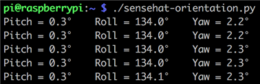

Getting the orientation for all 3 axis can be done with a single call: "get_orientation". The data is returned in degrees. Note that no delays should be added in the function, as the sensor relies on multiple measurements to calculate the values. Adding delay will result in incorrect values.
sh = SenseHat()
try:
    while True:
        pitch, roll, yaw = sh.get_orientation().values()
        pitch = round( pitch, 1 )
        roll = round( roll, 1 )
        yaw = round( yaw, 1 )
        print( "Pitch = %s°    Roll = %s°    Yaw = %s°" %(pitch, roll, yaw) )
The output:

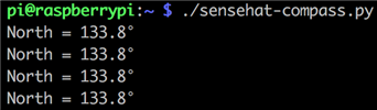

The magnetometer can be used for compass applications:
sh = SenseHat()
try:
    while True:
        north = sh.get_compass()
        north = round( north, 1 )
        print( "North = %s°" %(north) )
Unfortunately, those results seemed unreliable (or I was testing it incorrectly), as when turning the board around it's Z axis, the north would remain between 120° and 150° while I would expect it to go from 0° to 360°.
Turns out a calibration file is provided by default, which should cover most cases. Not working as expected, I deleted it, and ran the calibration steps described here.
The result was better, as I was able to cover the entire range of values:
North = 49.2°
North = 49.2°
North = 358.7°
North = 358.8°
North = 12.0°
North = 12.1°

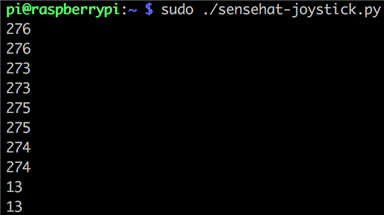

Joystick
To be able to scroll between menus and trigger actions, a 5 button joystick is foreseen.
The buttons of the joystick are mapped to keyboard keys: cursors and return key. Using code, it is possible to catch those events and trigger actions accordingly.
import pygame
pygame.init()
pygame.display.set_mode((640, 480))
try:
    while True:
        for event in pygame.event.get():
            print(event.key)
Pressing the joystick's buttons results in the following output.
There are 5 different numbers, repeated twice. The repetition represent the "press" and "release" actions. The actual numbers are key codes. A listing can be found here, the sequence above is then decoded as "left", "up", "right", "down", "enter".

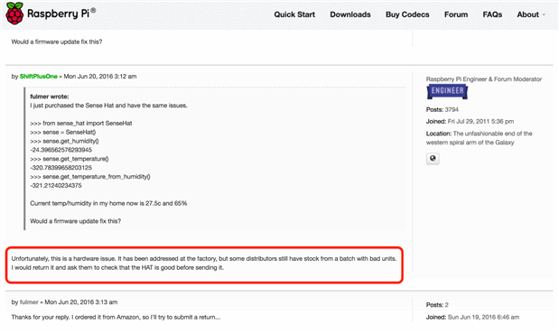

There seems to be an issue with some of the Sense HATs used in this challenge.
The problem first surfaced when vish created a discussion about his HAT reporting negative temperature and humidity. Using the same code, mine reported correct values. The next day though, I was suddenly suffering from the same negative temperatures. Doing some searching online, I came across this thread on the official Raspberry Pi forums, in which it is described as a hardware issue, which has been resolved in the factory in the mean time. Some faulty units could still be in stock at some distributors though.
Could this be the same issue?
In case the humidity is not important for your application, there is no blocking issue, as the temperature can be retrieved from the pressure sensor instead.
