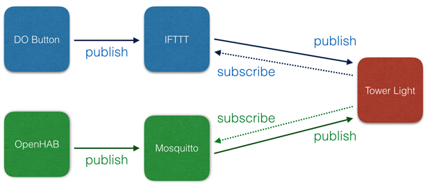

Because the light currently uses the IFTTT service, it requires an active internet connection. This may not always be the case though, so in order to ensure local control without internet, a new mechanism needs to be added.
The protocol of choice for most in this challenge has been MQTT, and it won't be different for this project. I modified the Photon's code to add support for MQTT. This means the Photon will now listen to events from both IFTTT and MQTT, ensuring backwards compatibility with the DO Button app.

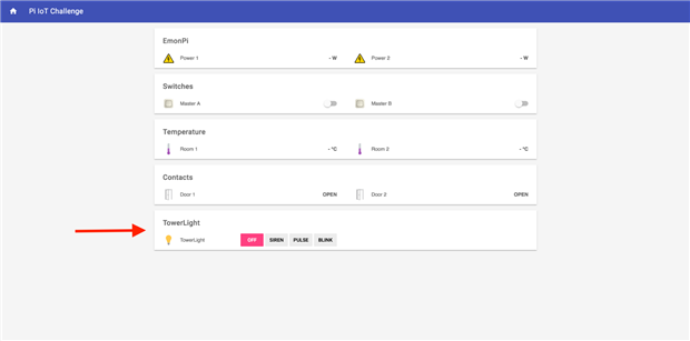

The integration in OpenHAB is rather straightforward.
First, a new numeric item is defined, linked to the MQTT binding. It is configured such that the value of any command received on this item is published to the MQTT broker:
Number TowerLight <light> {mqtt=">[piiot:TowerLight:command:*:${command}]"}
Next, the item is added to the sitemap. Note that it is using the "switch" definition. The possible numeric values are linked to labels, to have meaningful buttons in the GUI:
Switch item=TowerLight label="TowerLight" mappings=[0="Off", 1="Siren", 2="Pulse", 3="Blink"]
This results in four buttons, each with a different label, linked to a command. When clicked, the command is passed to the item, which in turn triggers the linked MQTT binding.

In the GUI, the buttons are visualised like this:
Because the MQTT broker is on the local network, as opposed to the IFTTT service on the internet, the responsiveness has improved greatly.
