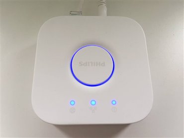

Hue Bridge
The Philips Hue Bridge is, as the name implies, a bridge device allowing your smart devices (phone, computer, Raspberry Pi, ...) to control up to 50 Hue lights and accessories. It connects to the network via an ethernet cable and receives an IP address via DHCP. As I'll be controlling the bridge from OpenHAB, it will need to be configured with a static IP address instead. This can be done using the Hue app.

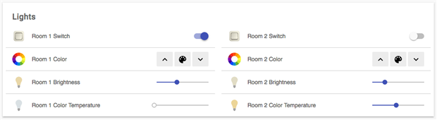

Sitemap
The sitemap is like any other integration, where you define how and where the defined items are visualised.
        Frame label="Lights" {
                Switch         item=Hue_Bulb_1_Switch   label="Room 1 Switch"
                Switch         item=Hue_Bulb_2_Switch   label="Room 2 Switch"
                Colorpicker    item=Hue_Bulb_1_Color    label="Room 1 Color"
                Colorpicker    item=Hue_Bulb_2_Color    label="Room 2 Color"
                Slider         item=Hue_Bulb_1_Dimmer   label="Room 1 Brightness"
                Slider         item=Hue_Bulb_2_Dimmer   label="Room 2 Brightness"
                Slider         item=Hue_Bulb_1_ColorTemperature   label="Room 1 Color Temperature"
                Slider         item=Hue_Bulb_2_ColorTemperature   label="Room 2 Color Temperature"
The above configuration results in something that should look like this:
Pairing
Once the Hue binding was installed, OpenHAB detected the bridge automatically. In order to be able to pair with the bridge and send commands, the button on the bridge needs to be pressed. This is made clear in the "openhab.log" file.
After pressing the button, a unique user is created, allowing OpenHAB to interface with the bridge. The bridge then goes from OFFLINE to ONLINE, as stated in the logs:

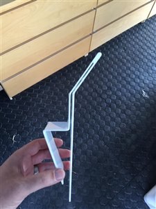

Build

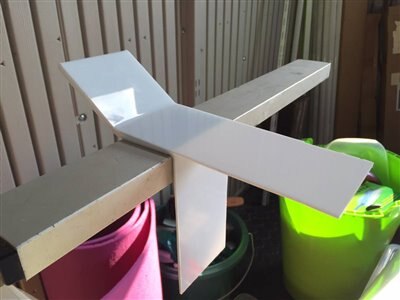

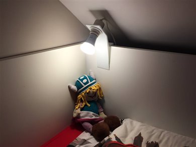

To build the frame of the light and be able to mount it on the beds, I experimented with a new method (new for me at least): heat forming acrylic. Applying heat to certain areas of a piece of acrylic, it can be formed in different shapes. Since this is my first time doing it, the shape is not so complex, but it turned out quite well if I may say so myself.
Here are some pictures of the acrylic being bent into shape:
As you can see, it's possible to make interesting shapes out of a straight piece of acrylic. The tricky part is figuring out the best order to perform the bends in.

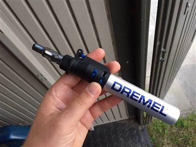

To apply heat, I used a mini blow torch and passed back and forth in a line across the section that needed to be bent. Using a different head of the tool, I carved out a hole in the top section to fit the light's socket. Handy little tool! image
Now I just need to repeat this for the second bedroom!
