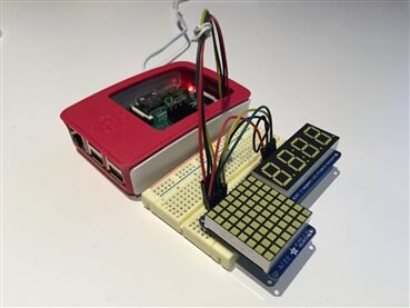

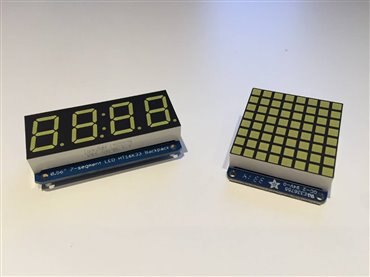

This post will be about the display of the actual alarm clock. It will consist of two components, visualising different information.
Enabling I2C
Both components, a 4 digit 7-segment display and a 8x8 LED matrix, make use of an I2C backpack to facilitate wiring and control.

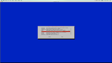

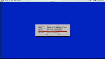

To enable I2C on the Raspberry Pi, launch the "raspi-config" tool from the command line. Select the advanced options and go to the I2C menu. When asked, enable I2C. Reboot the Pi for changes to take effect.
Install the "i2c-tools" package if not already done so, as it will help verify all is as expected:

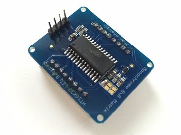

Initially, both displays have address 0x70. It is however possible to short some pads at the back using solder, changing the address to a different value:

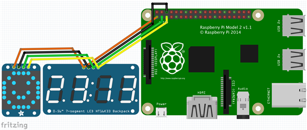

Let's take a look at how I connected them to the Pi
Connecting Hardware

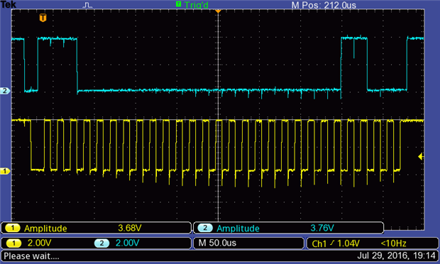

3.3V vs 5V ?
The safest option is to connect everything using 3.3V, as the Pi's logic level is 3.3V and using 5V may damage the Pi. The connections would then look like this:
Because the displays I used are supposed to be "super bright", powering them using 5V instead of 3.3V would result in the best brightness output. I was however worried as the Pi's I/O uses 3.3V levels. But would powering the displays using 5V damage my Pi's I2C pins?
Doing some research, I found an old discussion from fustini asking the same thing: Is level shifting really needed for I2C?  Ultimately, I verified the voltage on the I2C pins using a scope, and it seems it is safe (in this particular case) to power the displays using 5V instead of 3.3V and not damage my Pi's I2C pins image

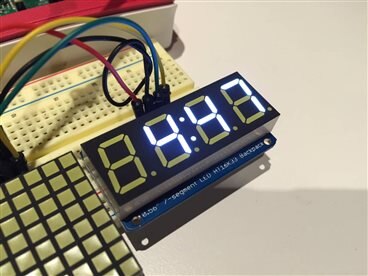

7-Segment Display

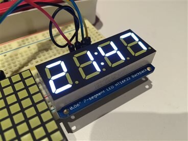

This will be used to display the most basic information an alarm clock should display: the time.
I wrote a small Python script taking the time, parsing the hours and minutes and concatenating them in a single value. That value is then sent to the display to be visualised. For the colon, it is simply alternated every 500ms image
The small script is defined below:

To verify the placement of the colon and the time, I temporarily set the time to Japan and then back to Belgium.
pi@piiot1:~ $ sudo cp /usr/share/zoneinfo/Japan /etc/localtime
pi@piiot1:~ $ sudo cp /usr/share/zoneinfo/Europe/Brussels /etc/localtime
This is the result:
Looks like the time is taken care of, on to the next display!

    mcb1 over 10 years ago +1
    power the displays using 5V instead of 3.3V and not damage my Pi's I2C pins I had the same issue with a wireless receiver using the 3v3 RFM69 devices and an I2C LCD display. Luckily the I2C is pulled up…
    Great post. It includes a good quick-start guide to manage I2C.

    fvan over 10 years ago in reply to mcb1
    Thanks Mark image
    Luckily the I2C is pulled up on the sender end, hence it remained at 3v3 ...
    Very useful post.
    Cheers
