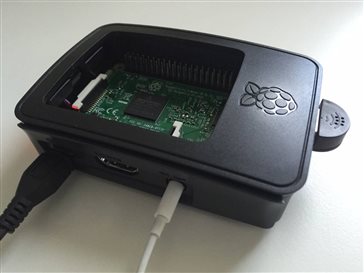

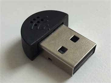

First things first. To be able to do voice control, we need to have an audio input device on the Pi. A USB microphone is probably the easiest and cheapest option.
I found this tiny USB microphone on eBay for about $1:
To verify it was properly detected, I listed the recording devices with following command:
pi@piclock:~ $ arecord -l
**** List of CAPTURE Hardware Devices ****
card 1: Device [USB PnP Sound Device], device 0: USB Audio [USB Audio]
  Subdevices: 1/1
  Subdevice #0: subdevice #0
Next, trigger a recording and generate some sound:
pi@piclock:~ $ arecord -Dhw:1 -r 44100 -f S16_LE file
Recording WAVE 'file' : Signed 16 bit Little Endian, Rate 44100 Hz, Mono
^CAborted by signal Interrupt...
And finally, verify the recording by playing it out:
pi@piclock:~ $ aplay -Dhw:0 -r 44100 -f S16_LE file
Playing WAVE 'file' : Signed 16 bit Little Endian, Rate 44100 Hz, Mono
You should be able to hear the recorded sounds, indicating the microphone is working as expected.

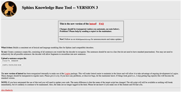

Dictionary & Language Model
The required input is a "corpus" file, a file containing the phrases that need to be recognised. This file can then be fed to Sphinx's lmtool to generate the dictionary and language model files.
As explained on that page:
To use: Create a sentence corpus file, consisting of all sentences you would like the decoder to recognize. The sentences should be one to a line (but do not need to have standard punctuation). You may not need to exhaustively list all possible sentences: the decoder will allow fragments to recombine into new sentences.
Example questions for my application are:
  • is the door of the shed closed
  • is the door of the shed open
  • what is the temperature in the shed
  • turn on the lab light
  • turn off the lab light
Two of these generated files are relevant: the *.dic (dictionary) file and the *.lm (language model)
For ease of use, renamed the files to "dictionary.dic" & "language_model.lm".
