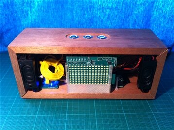

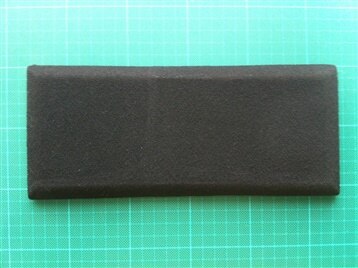

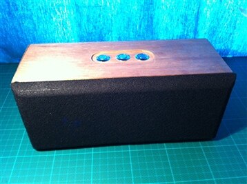

Here it is, the final look of the alarm clock.

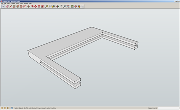

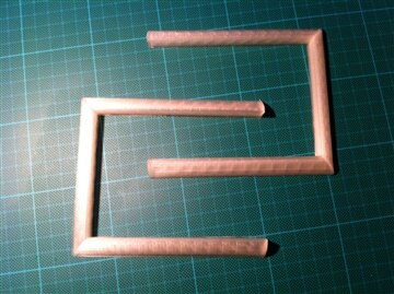

I printed a bracket able to hold the LED matrix so that it remains correctly positioned, but is still removable. Then came the front panel for which I printed a frame with rounded edges to which I attached some spare speaker cloth I had laying around.
I chose the speaker front panel for following reasons:
  • it softens the light produced by the LED matrix, making it easier to read (and easier on the eyes at night!)
  • the integrated microphones of the Wolfson audio card remain "accessible" for voice control purposes
  • I think it looks good image

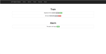

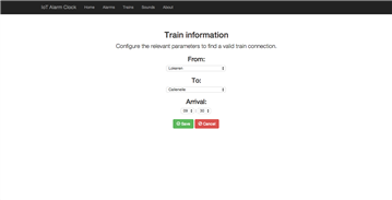

The web interface has been finalised. It offers different pages, each with their own functionality:
  • Overview: Chosen train information and to what time the alarm is set
  • Trains: Search criteria for the train connection
  • Alarms: Configured alarms
  • Sounds: Configured sounds available for alarms, supporting files and internet radio streams
All data such as train information and train stations is retrieved dynamically via the iRail API for Belgian public transportation.
Some pages require to be visualised in landscape mode due to long text (url/path):

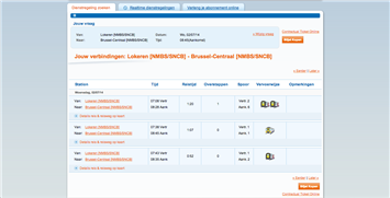

To go from Lokeren to Callenelle, the clock picked the train leaving at 05:22, and decides to set the alarm fro 04:52, taking into account 30 minute to get prepared and go to the station.

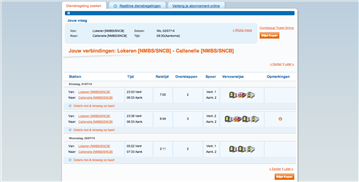

When performing the same query on the railways website, we see there are multiple options, but the clock picked the most appropriate one.
A second example, still from Lokeren, but this time to Brussels Central:
This second example illustrates the fact that the application will select the train that allows to sleep as long as possible, while still arriving on time.
One of the trains arrives exactly at the desired arrival time, but leaves earlier. The application therefore decided to pick a train that arrives a little bit earlier than desired, but allows to sleep longer than the one arriving exactly on time.
