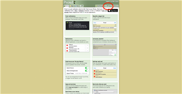

Finally, configure the addon with the necessary parameters. In case of the prowl notifications, and API key is required. This key can be obtained by creating a free account on https://www.prowlapp.com.
Once you have a key, create the prowl service config as follows:

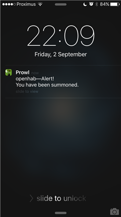

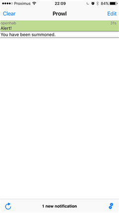

On the client (your smartphone, tablet, etc ...) an app is required: Prowl. Download and install the app, use the same credentials to log in as used to request an API key. You are now ready to receive notifications!
When the above rule is triggered, a notification appears in the device:
Et voila, custom notifications!
