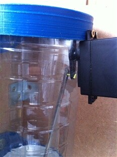

Food Dispenser
The food dispenser prototype I had built early on didn't seem to work properly after all. The cat food was jamming and wouldn't dispense reliably. I had to come up with another idea, and fast.
To prevent the food getting stuck and not dispensing, I thought something should move inside the food container.
This is the new mechanism I've come up with:
It's not so nice looking, but it does the trick, and now the mechanism works reliably.
The software part of driving a servo with the RPiSoC could be reused, it's just the dispensing mechanism itself that changed.
