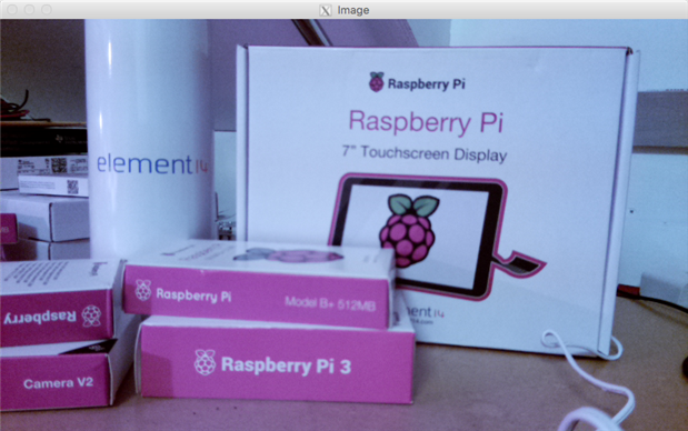

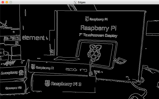

Now let's try a small demo program, in this python script a camera image is grabbed, and a canny edge detector is applied, showing the edges in the image. Both the input image and the edges are displayed.
# import the necessary packages
from picamera.array import PiRGBArray
from picamera import PiCamera
import time
import cv2
# initialize the camera and grab a reference to the raw camera capture
camera = PiCamera()
rawCapture = PiRGBArray(camera)
# allow the camera to warmup
time.sleep(0.1)
# grab an image from the camera
camera.capture(rawCapture, format="bgr")
image = rawCapture.array
edges = cv2.Canny(image,100,200)
# display the image on screen and wait for a keypress
cv2.imshow("Image", image)
cv2.imshow("Edges", edges)
cv2.waitKey(0)
This gives me the following result:
Success!
