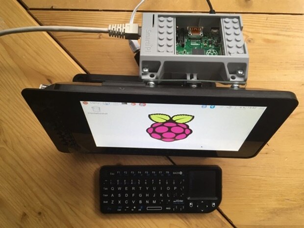

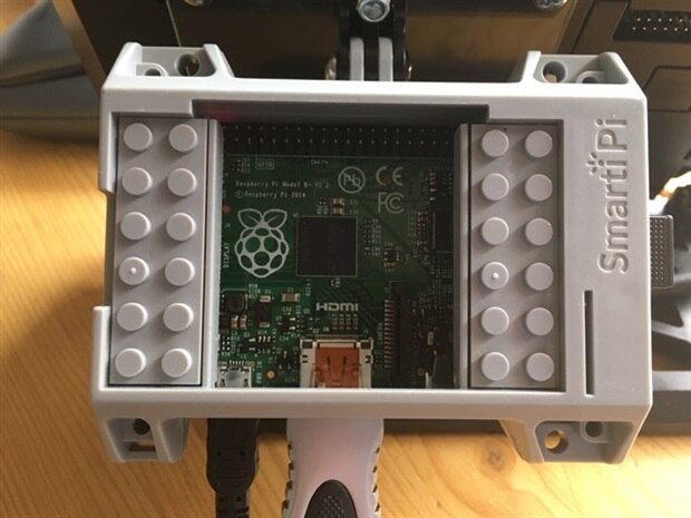

The in the kit supplied Raspberry Pi B+ is used as slave camera unit. I placed it in the grey Smarti Pi 'LEGO' case.
Raspbian is installed from a NOOBS image which I put on a 16G SD card.

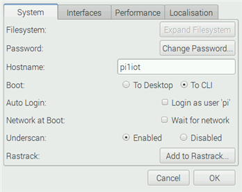

After installation it automatically boots into graphical mode. I made some changes using the Configuration tool.
As hostname I use pi1iot (the other ones hostname is pi3iot). Since we don't need the graphical user interface the Boot option is changed to CLI (Command Line Interface). Also Auto Login is disabled. In the interfaces tab the Camera is enabled, and in the Localization tab the proper timezone is set.

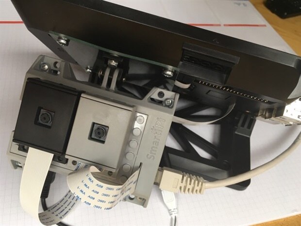

Connecting the cameras

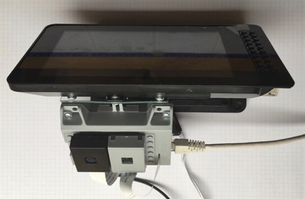

The standard camera cable is too short to connect to the Pi 3, therefore I ordered a longer (30 cm) cable.
The two cameras are placed next to each other on the LEGO cover of the second Pi.
For the time being the second Pi is connected via ethernet.
