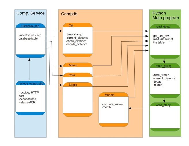

Competition database
It will be hosting two kind of tables:
  • Roommate information table - with the current distance, the daily distance and the monthly distance time stamped. In this case, we are 4 people in the house
  • Winner information table - with the winner and the month they won
Information transaction
Most of the information will be stored from the Compatition service, as explained in [Pi IoT] Smart Competition Home #8: Competition system III - Android Competition application: communicating with the server (Each roomates distance information). Then, the Python main program will retrieve that information and display the competition in its main GUI. It will also determine who is the monthly winner at the end of each period.
Nevertheless, the main python activity will be the one handling the winners table. Once we change to a new month, it will use the last monthly_distance value of each resident to selectand store that past month winner.

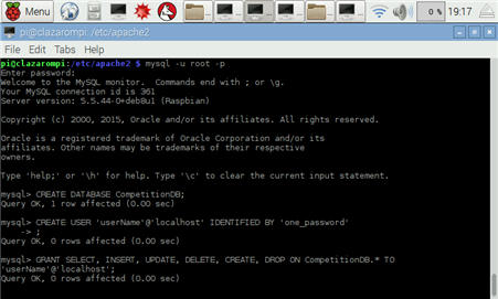

Let's begin...  On a command prompt of the central node, we start mysql service as a root user
Create a new database
A step 0, create the database to use:
> CREATE  DATABASE Competitiondb;
And start suing it (~open)
> USE Competitiondb;
Creating a new mySQL user
To create a newlocal  user, we input the following SQL command:
>CREATE USER 'userName'@'localhost' IDENTIFIED BY 'password';
To grant permissions (in my case SELECT, DELETE, CREATE, DROP {table}, INSERT, UPDATE {into table})
> GRANT SELECT, INSERT, UPDATE, DELETE, CREATE, DROP ON Competitiondb.* TO 'userName'@'localhost';

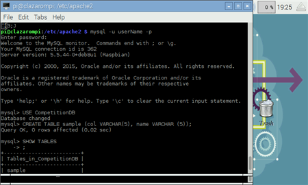

Testing the new user
To test this user, I will create a new mock table and then erase it. We will see the number of tables with SHOW TABLES command (none at this point)
Here is the screenshot:
We keep 'userName' and 'password' information to be used in any code accessing the database

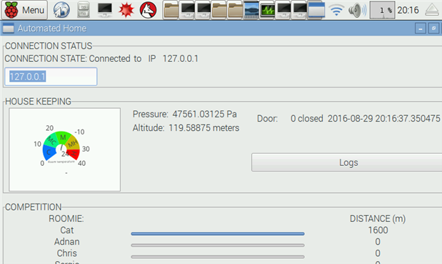

Updating Central Node GUI
Initial setup: Raspberry Pi 3 - Raspbian SO (Jessie) / SSH Enabled / Mosquitto MQTT Broker installed / MQTT Subsciber client / Console interface / Python GTK interface /  MySQL Server / Apache2 web Server / Competition Service version 1
The GUI is already prepared to host the current competition table (showing each residents progress, and having them organized with the best on top). More details on how it was done, can be found in[PiIoT] Smart Competition Home #5: Central Node Upgrade
(*) last version of the Central Node Code
Read database and display
New File - read_db.py
Existing file - main_gui.py

The main_gui.py will call the function read_last_sample(table) every time a gui label is updated. It will refresh the last values for each of the roommates
Manage competition state and store new winner in database
New File - write_db.py
In this case, the main_gui will detect when a new month starts, and select the best resident during the previous one. It will be stored in winners table, using the file write_db.py (very similar to read_db.py, though it executes an INSERT query)
GUI with the updated competition table
(What a coincidence... I am winning image )
