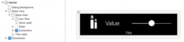

Now we can actually implement the SliderTile itself. First we add the slider to the UI:
The TileCollectionViewCell class got some more functionality now. To make things easier I moved some of the logic from the TilesCollectionViewController to here. It now takes care of deciding what to show and what to hide. For example the value will be hidden when there is no value (for buttons) or when a slider is used (the slider already visualizes the value).
To handle changes of the value when someone uses the slider a delegate method had to be added. The slider is linked to the delegate method in the TileCollectionViewCell, but this delegates the actual work to the SliderTile. This class also has some properties defining the slider, such as the minimum and maximum allowed values, and takes care of updating the slider when a MQTT message arrives.

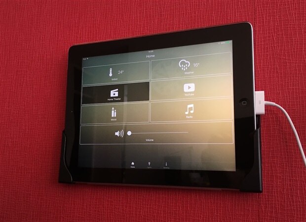

Changes to support iPad
The iPhone and iPad have a very different screen size and of course we don't want to duplicate any code, or add checks everywhere. Luckily for us Apple solved most of this by providing adaptive layouts and layout constraints. We'll use the latter to slightly change the layout of the TileCollectionViewCell to adapt to the bigger screen. Apple differentiates between devices by using so-called size classes, which are very well described in The Adaptive Model. There are two changes we have to make: change the icon size and the width of the slider. The icon will be 45 points on compact-width devices and 70 on regular-width devices. The slider will get a width of 200 points on compact-width devices and 400 on regular-width devices.
Determining the size of the cell was already working well on all devices as it's using a size based on the size of the superview. You can see the implementation of the slider above.

The implementation of the design Marina made for the Thuis app is now implemented, and how better to show it then with a demo:
In the demo you can see the different screens on both an iPad and an iPhone. At the bottom you can see the MQTT messages being send and received. Notice that when clicking a button a message is send to the set-topic (for example Thuis/device/living/moodTop/set) by the iOS app. Then a message is received on the status topic for that device (Thuis/device/living/moodTop), which is sent by Zway.
When a scene is triggered (in this case Mood, which are the mood lights in the living room) you see the Core sends a message for each device in that scene. The status is also reflected on the iPhone. The slider for the main light in the dining sends out messages every time when you pause for a tenth of a second.
