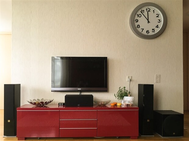

An important part of Thuis is integration of our Home Theater system. As the integration is quite extensive and consists of several components, this will be a 3-part blog series. In the first part we start with communicating to CEC-enabled devices from a Raspberry Pi. In the second part we will integrate CEC with the rest of Thuis, and make sure everything works properly together. In the third - and last - part of the Home Theater series we will add the support for Plex.
CEC
Let's start with a short introduction of CEC itself. CEC stands for Consumer Electronics Control and is a feature of HDMI. CEC enables HDMI-devices to communicate with each other. In the ideal situation this means a user only needs one remote control to control all his devices: TV, AV receiver, Blu-ray player, etc. Unfortunately many manufacturers use their own variation of CEC and therefore in a lot of cases one still needs multiple remotes. To get an idea about the protocol have a look a CEC-O-MATIC, this is a great reference for all available commands!image
The good news is that the GPU of the Raspberry Pi supports CEC out of the box!
libCEC
To be able to handle the different dialects of CEC, Pulse Eight developed libcec. It enables you to interact with other HDMI devices without having to worry about the communication overhead, handshaking and all the differences between manufacturers. In contrast to what I mentioned in [Pi IoT] Thuis #5: Cooking up the nodes – Thuis Cookbook Raspbian Jessie nowadays provides version 3.0.1 in the Apt repository, so there is no need to use the version from Stretch anymore. I've updated the cookbook accordingly. Other than that provisioning the Raspberry Pi using Chef was straightforward.
