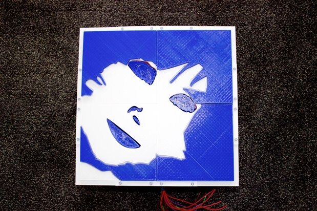

The Art-a-tronic opera is totally 3D printed and the final assembly has been finished. To make the final moving object (35x35x20 cm size) it was necessary to design 28 different mechanical parts resulting in 41 different printed pieces:
  • 13 White parts: the image background
  • 7 Blue parts: the moving shapes of the image
  • 11 Black parts: elements and supports to make the blue parts moving
  • 7 Orange parts: to lock the special nut moved by the vertical axis
  • 4 Red parts: to create the support base and the stepper motors support to the bottom of the moving elements.
{gallery} Components design
The white parts composing the background exposed surface (35x35 cm)
The four blue parts composing the main shape. These parts moves toward the viewer laying on the white background
The three blue parts composing the image details (eyes, nose and lips). These parts moves inside the background holes from the bottom of the base
The eleven black parts supporting the blue parts movements
The four red parts. When assembled these are the main base of the entire structure.

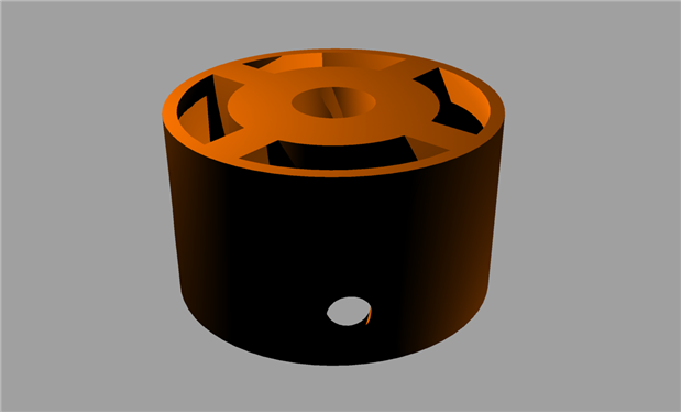

The special nut motion screw holder, top view
The special nut motion screw holder, bottom view
The images below shows some details of the final assembly
Every vertical moving part has an actuator built with a 28BYJ-48 geared stepper motor controlled by a LM298 motor controller; a total of 7 steppers + 7 controllers.
Stepper screw holder changes
As shown in the above images the original design for the stepper screw holder was 3D printer components too. The reason was the difficulty to find on the market similar metal components cheap and of the exact measure to fit the design. An easier solutions has been adopted instead as I have found strong and semi-flexible small hose: this material common use if for fuel and gasoline, so it is also resistant including temperature and solvents. And easy to manage and cut too. The images below shows in detail shows the final assembly.
