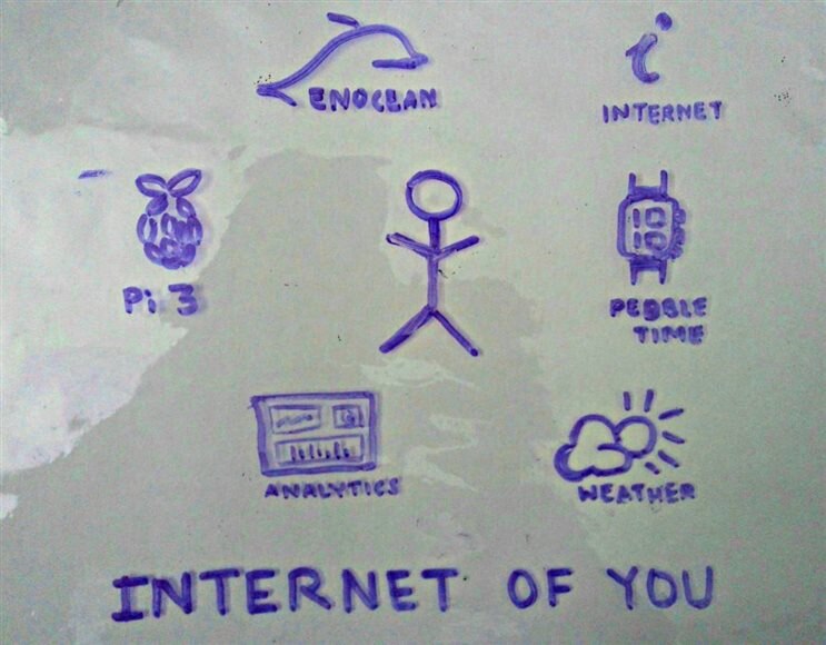

I believe that internet of things is not just about connecting just things together. It should be about connecting people to their things in a meaningful and easy to access way. Although 'things' play an important role, ultimately IoT should make people's life better. It should not be just about monitoring things around you, but about making a symphony between the user and his/her things to enrich their daily life. My project proposal for this challenge aims at putting things and users together - exploring new ways how personal IoT can help us.
Internet Of You

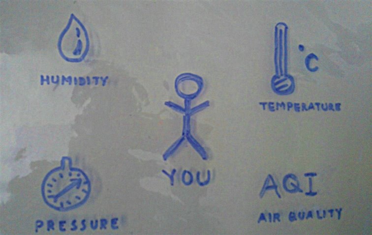

For this challenge, I want to look into three different aspects of an user - environment around him/her. things attached to him/her and finally his/her health itself.
The Environment:
By environment, I mean the personal space around us, the ambiance and the nature. One of the best use case will monitoring the temperature, humidity, air quality etc., around you. By using the Pi Sense Hat, I will be able to measure the temperature, pressure and humidity of the environment. And in my city, we have public access to the AQI data. Together with the weather reports fetched through Yahoo Weather API, this will give the user a comprehensive  way to plan his daily activity. All these data will displayed in the screen provided for the challenge. I'll be using freeboard with nodejs to collect and data and update it to the dash board.
