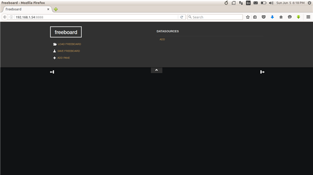

This will start the nodejs sever and you will be able to see freeboard editor loaded by default. Now go to http:/<Pi's IP>:8888/ from your web browser. You will be able to see a webpage like the one below. Yayy... you are now successfully self hosting Freeboard.
The interface is so intuitive that it barely needs an introduction. You can add first sources for your data under "Datasources". Then Click on "Add Pane" to create widgets.

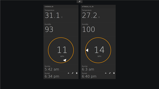

Since I don't have the hardwares for the challenge yet, I'm going to display weather data from my current town and hometown via Yahoo Weather. This where freeboard is really awesome. I can create a dash board design, share that JSON file with my friend and he can also instantly get the dashboard. SO I have already designed my dash. You just need to copy it and use.
Go to "freeboard" folder. Download and save "dash_weather.txt" attachment in this folder. Rename it to "dash_weather.json".
Now you can visit http://<PI's IP>:8888/#source=dash_weather.json from you browser. This will display the dash board designed to show weather from two places in India, my country.
To edit the places, go to Add Source section and edit the URLs to suit your place. You can get help from https://developer.yahoo.com/weather/ to find your place.
