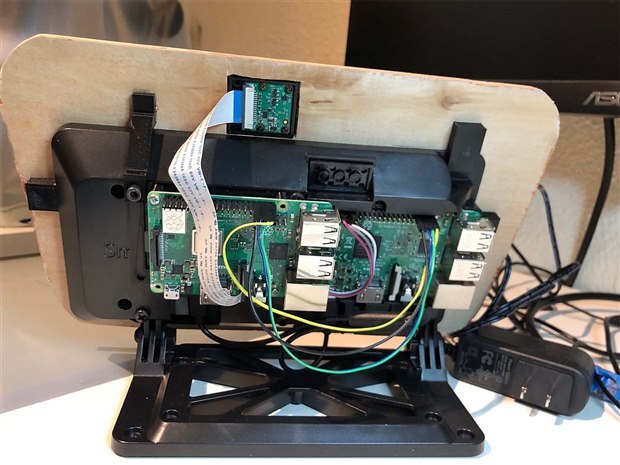

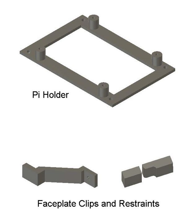

For the time being I have simplified the enclosure on the back side of the display.  This leaves wiring exposed if viewed from the back but at the same time it enables easier access while getting things sorted and does not detract visually from the front side of the prototype.  A new mount for the second Raspberry Pi (which runs the image recognition) was printed and screwed into place.  Clips and tabs were printed to secure the faceplate to the monitor and stand.  Everything is now glued and screwed together and acceptably sturdy.
With the mount, tabs, clips and restraints in place it looks like this from the backside:
Working with a second Raspberry PI has made things more complicated than originally imagined.  For example there are mechanical complications to strapping a second Pi to the back and resulting space / access issues.  Power is an issue since two USB supplies are required.  Software development is more tedious.   As will be discussed below however, the Pi doing the image recognition is fully loaded and trying to do that and run art displays with a single Pi would bog things down.

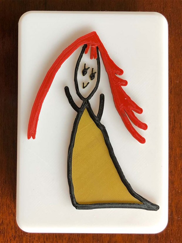

For this print, 4 colors will be used.  Since my printer only has one print head, each color will have its own layer, and subsequent colors laid down on top of it.  The printer can do layer heights of 0.1, 0.2, or 0.3 mm.  A minimum of 2 layers (and maybe more) is needed to get good color.  I elected to use 0.2 mm layer height while printing and 0.6 mm layer thickness for each color, so 3 layers.  The total thickness of the figure is 2.4 mm.

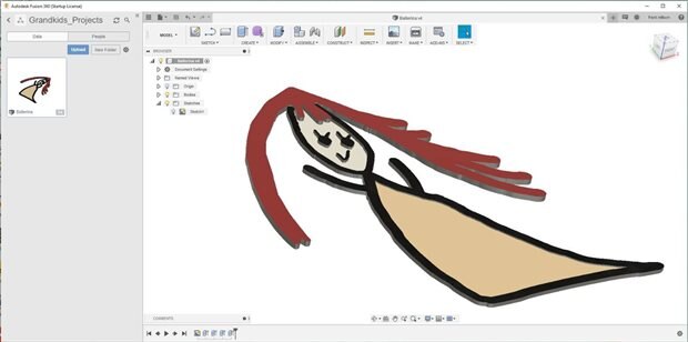

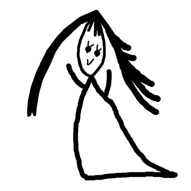

Her pencil sketch was scanned in and outlined in Photoshop and then converted to a SVG file at online-convert.com. I have been using Photoshop due to familiarity but I am familiar enough with Fusion 360 now that I will trying going straight to it next time.  The trick is to simplify the drawings and give adequate thickness to the lines such that the 3D printer can handle it.
The SVG file was pulled into Fusion 360 and the color layers extruded as described above.  The white layer covers the entire print, then the gold layer is on top of it followed by the black layer and the red layer.
When printing, I manually pause the print at each new color layer and change the filament before restarting.  And this is the result.
