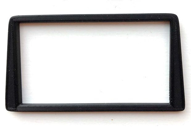

The cutout on the face was a bit ragged so a bezel was made to enclose the monitor opening.

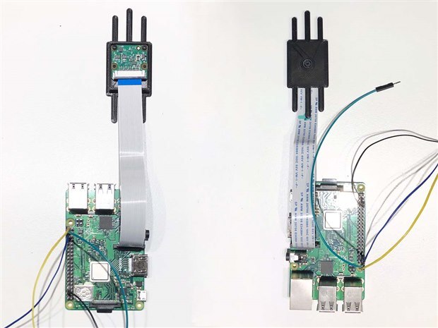

To hold the camera in place a bezel was fabricated for it also.  The camera is mounted with two locating pins and two screws.  The back and front is shown in the following photo.

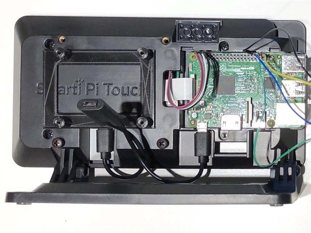

A Raspberry Pi mounting plate was made that attaches to the back of the monitor.

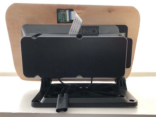

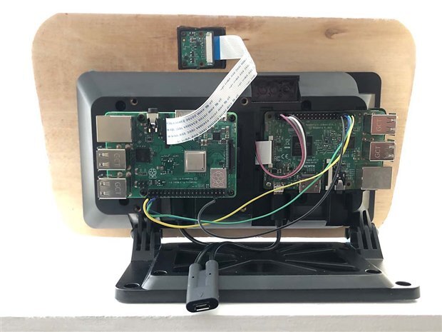

For now, some things are still held in place with mounting putty as I am still thinking about the best placement and aesthetics before gluing and screwing into place.  This shot shows the second Raspberry Pi mounted and the camera in place from the back.
I thought there would be plenty of room but of course now things are getting tight and the ribbon cable for the camera is a bit short.  Little fingers are bound to pry at the wires and things and the back enclosure does not quite cover things up.

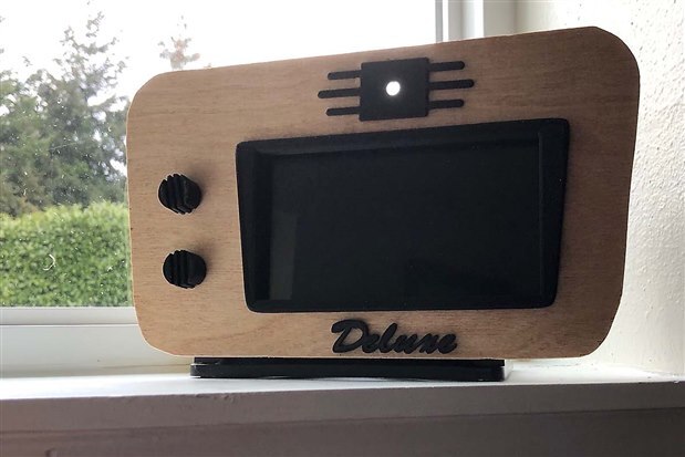

A call needs to be made though for when enough is enough for the first iteration though as the software needs attention as well.  The tradeoff will be between a fully functional prototype and refined physical design.  Since this is an art project, here is the beauty shot.
