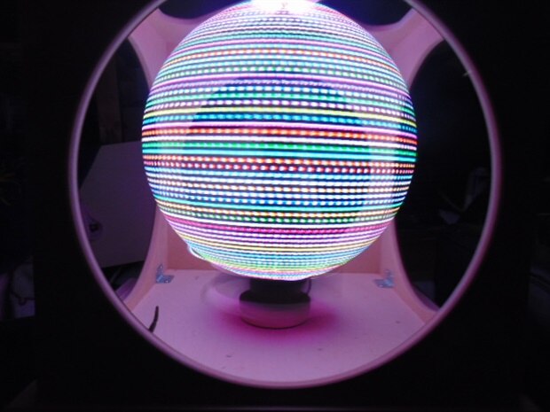

Today I have an update of the POV globe. I spent some more time trying to program the lights to produce random colours. This was very successful as you will see with the photos below. I included the Python3 script.

 pixels[x] = ((random.randint(1, 255)), (random.randint(1, 255)), (random.randint(1, 255)))  #Randomise colour
 time.sleep(.01) #Delay 100th of a second
 x = x + 1
 if x > 71: #Since there are 72 LEDs reset to the start
  x = 0
The script isn't very long but works great!!

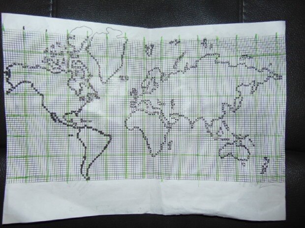

I have been working on programming the planet but that will be an all summer job. I created a graph to show how much work it will be to program. I divided the world into a grid so I can address the LED's correctly to display the world. And yes, I did draw this out myself...

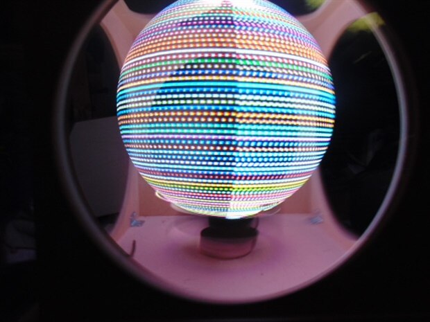

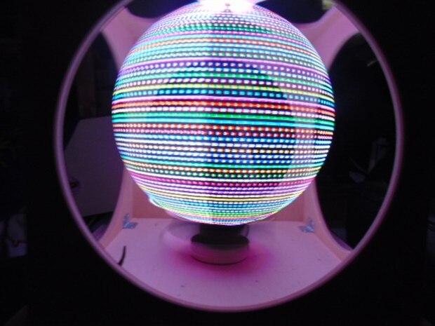

Below are photos of the new script running on the globe. Hope you enjoy!!
As you can see, in each photo the LEDs are a different colour. I love sitting and watching the globe, it is hypnotizing.

    dougw over 7 years ago +6
    This is a fabulous project with outstanding execution. Photographing flashing LEDs will always be highly problematic. If you can get a static pattern and take a time exposure through dark sunglasses, the…
  • dixonselvan
    dixonselvan over 7 years ago +4
    dwinhold wow really the LEDs are hypnotizing! Hope there should be an easy way to implement the world map in the globe. I assume the below can be a way we can implement it, 1. Take an image of the world…

    dougw over 7 years ago in reply to dwinhold
    Maybe you can start with something simpler - like a baseball. It will be even more awesome when you have a whole library of displays...

    balearicdynamics over 7 years ago in reply to dwinhold
    Thank you for your detail Dale. If you have no problem, next week I am a bit more free we can chat about the most efficient method to represent your drawing. via an algorithm, There are a couple of math solutions I have in mind and I think it is worth to try them.

    dwinhold over 7 years ago in reply to balearicdynamics
    Hi Enrico,
    My reply was to the 2nd part of your question (It was to early to think past that for me (4:30am)) image I am trying to think of an easy way to program all the pixels without having to do 1 column at 1 pixel at a time. This would be 72 LED's per column and 143 pixels per row (That is 10296 pixels). The other thing I realized is as the map moves towards the north and south pole the pixels get closer together, so I have to space the pixels further apart in order for the map not distort. Creating the map will definitely challenge my programming abilities, but that is the only way I will get better and learn more (Even at my age.....) I am open to any and all suggestions!!
    Dale, I mean what is your approach to control the neopixels representing the globe.
