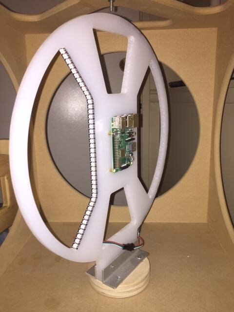

Hi everyone,

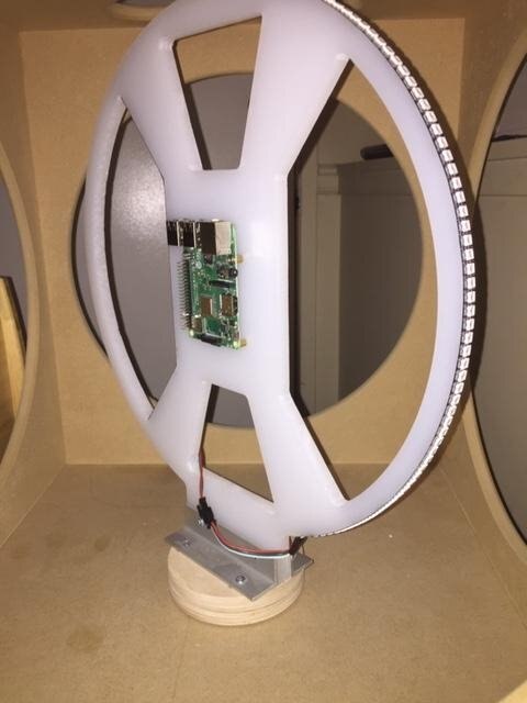

This weeks update is a bit more then I figured. I got quite a bit completed on the building of the globe. As you will see I created the base for the globe, top part to support the north end of the globe and have the LED's attached. I am trying to see if I can make it more 3D by giving it depth with a second row of LED's on the inside of the globe. This way I can produce 2 pictures at 2 different depths at the same time. As always, anyone want any of the .dxf files for this project please ask, I will send them out!!
Below are pictures of the globe so far:
Outside row of LED's
Inside Row of LED's

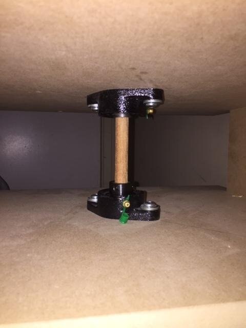

Support post in the bearings
I had to firgue out how to power the RPi and the LED's. Since the globe is spinning, I can't just run the power cord to the hardware for obvious reasons. I plan on using the bearings as the power connection. One for the positive and one for the negative. I will attach one half of the wire to the outside of the bearing and the other half to the inside. Hope it works!!

    balearicdynamics over 7 years ago +6
    Good progress, Dale. I appreciate the cleanliness of the design, very well done. Enrico
    dubbie over 7 years ago +6
    Dale, A very smooth turning action. The bearings must be working well. Have you given any thought to the wind or draught that might be created? For a flicker free image you might need to rotate at 50 revolutions…

    I've seen someone using an audio jack to transfer power, very clever idea https://hackaday.com/2009/10/15/72-led-persistence-of-vision-globe/
    genebren over 7 years ago in reply to dubbie
    I am using slip rings in my Picasso project. (https://www.newark.com/adafruit/775/accessory-type-slip-ring/dp/42X3604?st=slip%20ring ).  Here are some of the details (PiCasso Design Challenge - Kinetic Art Mobile - Post 2 )
    So far they are working great.  I will be doing some more testing on these soon to see if I can quantify the noise on lines.
    Gene
    dubbie over 7 years ago in reply to 14rhb
    This is good to know. I've never seen a proper slip connector for transferring power before.

    14rhb over 7 years ago
    Hi Dale,
    That is a very professional project build - even the woodwork looks really accurate. Well done so far, I'm looking forward to your blog #4.

    dwinhold over 7 years ago in reply to dubbie
    Hi Dubbie
    Speed is something I will have to be playing with. G-force, wind and draught is a bit of a concern and will have to be dealt with if it becomes a problem.
