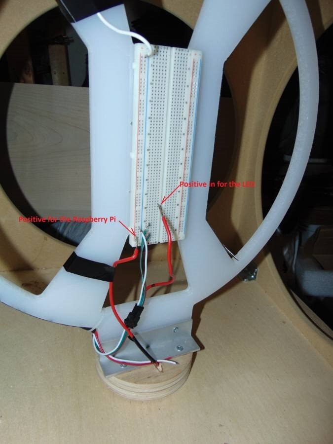

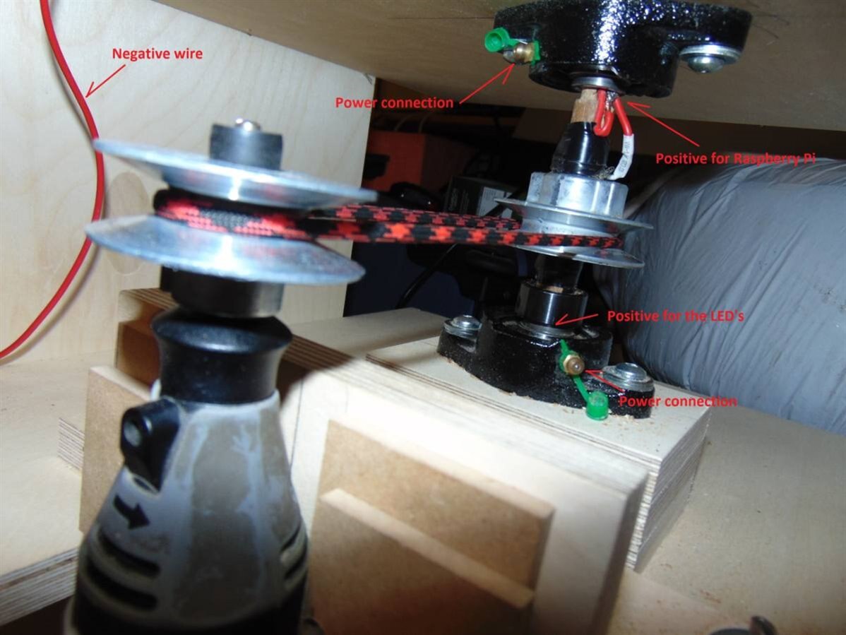

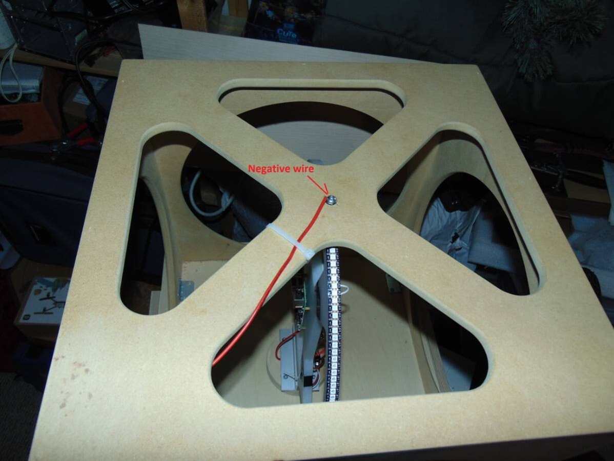

This update is the wiring of the power to the globe. The below photos and explanations of each, describe exactly what I did. I also include a video at the end.
First photo is of the Positive wires that power the Raspberry Pi and the LED's:
Next is the Negative out:
Next photo is of the underside at the bearings. The spindle is hand made of wood on a wood lathe. I drilled a hole down the middle for the wire to travel:

    Good update, Dale.
    I have a couple of points to have some clarification on your last progress, something that IMHO may risk to introduce some weakness to the rotation. As you should reach a considerable RPM and the globe is not small, why you don't use direct wiring and a breadboard PCB (soldered, I mean) instead of the plastic one? Also if it is relatively lightweight, as the rotation speed increase as much its mass influences a possible vibration or worst. With a soldered small PCB you can keep it perfectly aligned to the rotation axis eliminating this risk.
    The second is respect to the traction method. The new motor you used seems robust and reliable for the scope. As you already have trapezoidal pulleys, why don't use a trapezoidal belt instead of those I see? I mean those belts used for the car motors. You can find for cheap almost everywhere as spare parts of every diameter.
    Enrico
