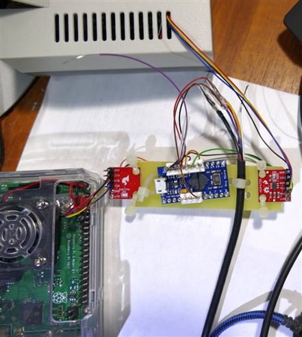

  • I had never figured out how to send absolute mouse HID position commands before, and there were differences in operation on a Raspberry Pi versus a PC, but I built an X-Y slide pot arduino mouse to help troubleshoot this part of the project and eventually got good absolute control of mouse position, which was crucial in allowing the finger position to dictate mouse position:

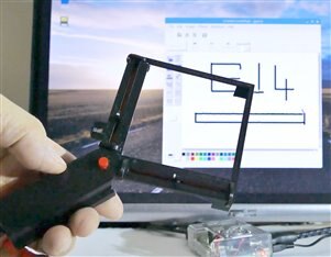

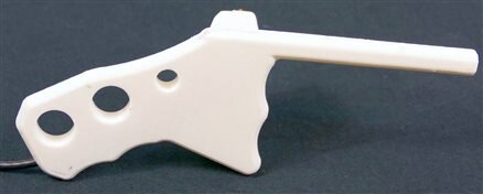

  • In order to enable precise drawing control, I designed a 3D printed pointer that could be used instead of a finger. I added mouse buttons to the pointer so that full mouse control would be available in one device. To provide even better control I added a 100% debounce circuit to the mouse buttons, which provided ultra responsive buttons with no undesired extra button pushes from switch bounces.

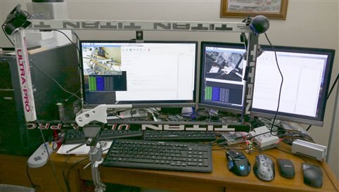

  • a fairly major issue I had was underestimating how much infrastructure I would need to bring up the full system. The system needed 5 computers which in turn needed 4 keyboards, 4 mice and at least 4 displays, and they all needed to  be worked on essentially at the same time. I was barely able to manage all this and I had to constantly switch which display was connected to which computer. The only way I could manage it was to use my PC "desk" and displays which are not well set up for lighting and blogging.
