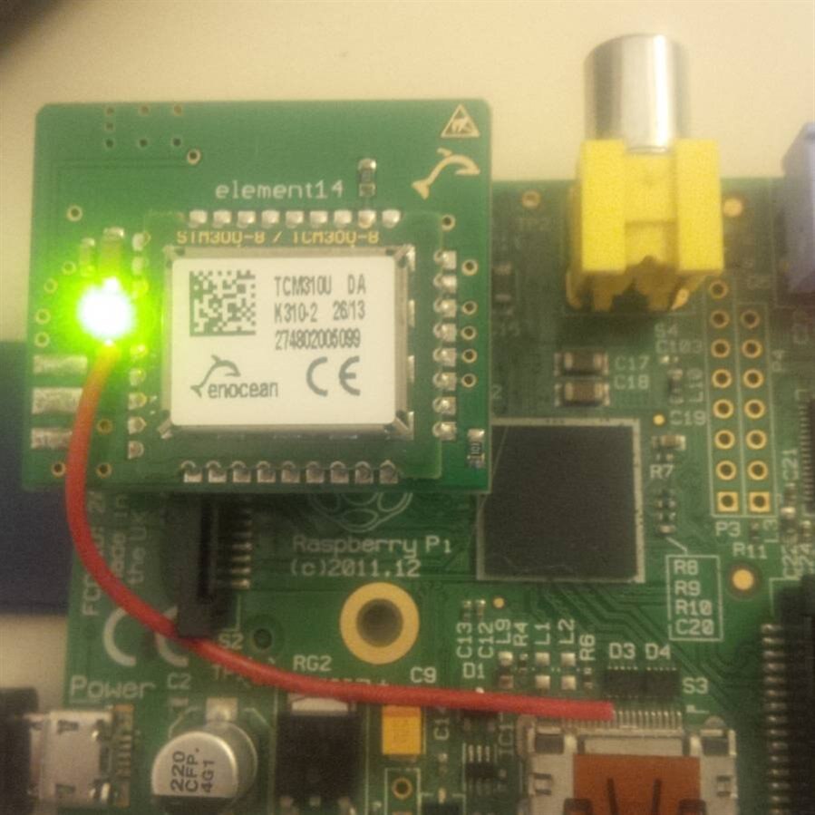

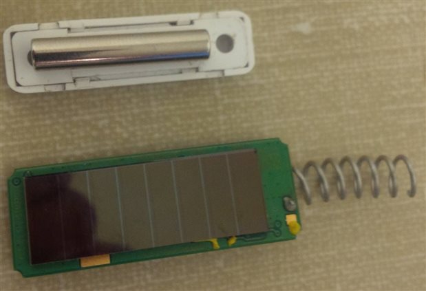

I am using Enocean Pi to sense if a door has been opened or closed. I also installed FHEM for testing.  The actuator is a reed or contact sensor. No batteries required or wiring for Enocean sensors. I installed FHEM

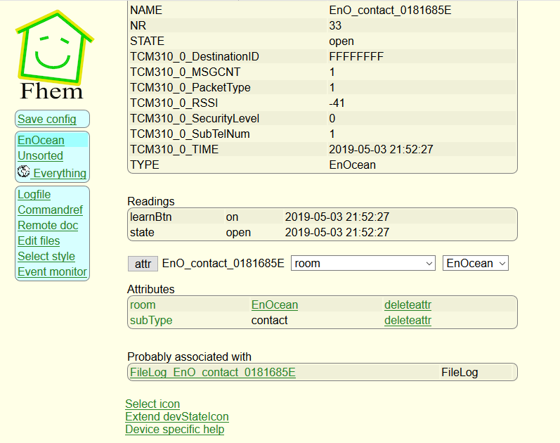

After some digging I did get the Enocean Pi to appear on FHEM. The link is here.
I have Enocean talking to the Reed Sensor and letting me know if a door is closed or open.

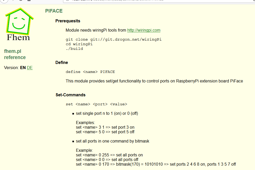

I was also able to add PiFace  to FHEM .
