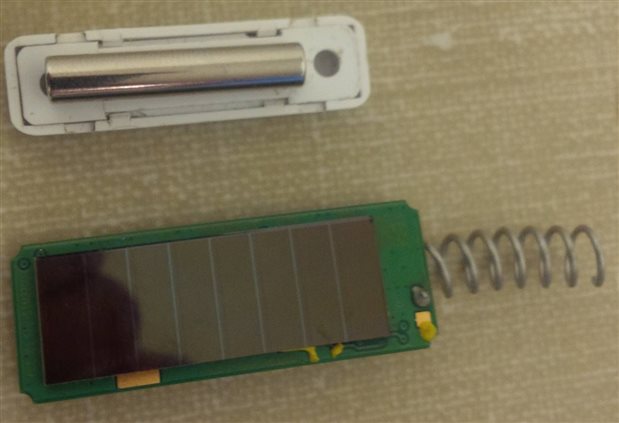

My original idea was to trigger a event if a door was open or closed. Depending on the event this would determine if a sketch would be played. So who should I impress with this idea ? Well Jim the cat is receiving a tent this weekend and I know she loves to follow the cursor on my laptop. As most cats she loves to lay on my keyboard and does not care if I cannot work. I talked to her about the design and this is her reaction.
Not to worry Jim. I know she might enjoy Optical Illusions from processing when she enters her tent. But now to the more technical challenges.
I am using Enocean Pi to sense if a door has been opened or closed. I also installed FHEM for testing.  The actuator is a reed or contact sensor. No batteries required or wiring for Enocean sensors. I installed FHEM

After some digging I did get the Enocean Pi to appear on FHEM. The link is here.
I have Enocean talking to the Reed Sensor and letting me know if a door is closed or open.
