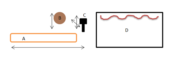

Project Overview:
As stated in the synopsis, I'm basically making a cnc cookie machine. Dough goes in, cookies come out. It easily extends to other baked goods as well, like homemade crackers and pie crust, but the first goal is to get some creative cookies perfectly cooked!
The machine consists of 3 main parts. A dough sheeter, the xy plotter and a toaster oven. The dough is flattened to the correct thickness, cut into the perfect shape, and then put into the preheated toaster oven, cooked, and removed - all while I take care of other, non-automated household chores (but more likely just stand there and watch it in fascination).
The Raspberry Pi will control the following elements:
  • Display what is being cut
  • Get and interpret gcode from a pre-selected shape
  • Move the platform and cutting head to coordinate as an xy plotter
  • Move the roller up/down/hold position
  • Temperature control on oven
  • Options for delay times, preheating, cooking time, pausing, allowing user to clear excess dough from pan before cooking, etc.
