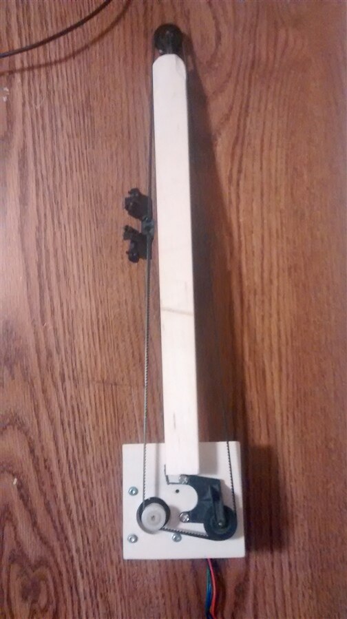

X-Axis:
I had a timing belt and some pulleys from an old printer I had dismantled a while ago and I decided to use this for the x-axis. I thought I could just put the timing pulley right on the motor shaft, but it turned out that the hole in the pulley was too small. I tried drilling the hole bigger, but I was afraid of removing too much material. So I decided to try heating up the hole with a heat gun and then smashing it onto the shaft. I put a piece of tin foil over the opening of heat gun and poked a hole in it so that the hot air would only heat up where I wanted.
After a little experimentation with that I tried heating the shaft of the motor instead. I had gotten the timing pulley on the shaft a little bit and as the shaft heated up, I hit the pulley with a hammer until it was on as far as I wanted. It ended up a little crooked, but I think it will be okay.
I assembled the whole thing around a long, skinny block of wood. On one end I drilled a hole for a pulley. On the other end, I attached a flat board and screwed the motor and other pulley to that. I didn't realize that the belt wouldn't have enough room to move, so I'll have to shave the end of the block down to allow it to move freely.
