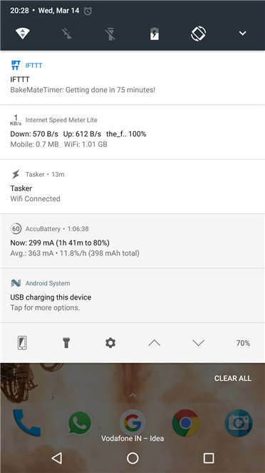

These screenshots (L to R) show how I set up IFTTT to generate a notification when an event is triggered (though it looks like I've mixed up the screenshots - some show BakeMateTimer, and some show BakeMateOvenTemp.
The last screenshot shows how IFTTT lets you format the data received as a String that is displayed in the notification. I passed the Recipe name, actual temperature and required temperature as payloads (values 1,2,3) and typed out the message I wanted to be displayed. IFTTT inserts the values as configured.

Bake Mate will periodically generate a notification as the timer counts down, and when it nears zero. A function in 'BakePage' also generates a notification when the temperature deviates more than 20C from the temperature required by the recipe.
Here's what the notification looks like for BakeMateTimer and BakeMate OvenTemp:
