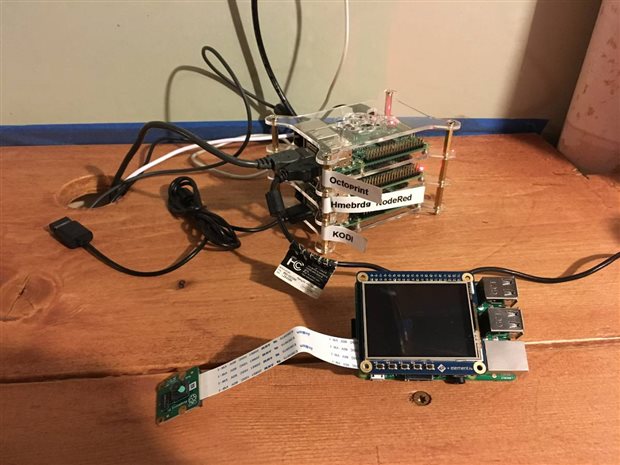

I powered up the Pi for the first time today [a few weeks ago; this post took a while to write]. I have it sitting down in my "server bay" for the time being.

- Install drivers for 4D systems touchscreen (really excited to run this!!!!)
I am starting with the 8MP camera plugged in, but the 4D Pi Hat removed as per the instructions. I am running the 2.5 amp supply from Newark. This will be very beneficial since anyone who has run Kodi knows that you can never have enough power. I've used a 500 mAh iPhone charger on rPi before and it can certainly cause issues. 1.5-2.5 amps is the real supply area to keep a complex power hungry system going.

The last bit for this objective is to get the screen up and running. I'll have a post later talking about the specific hardware connections since I need to use an extension cable and I may run into some issues...

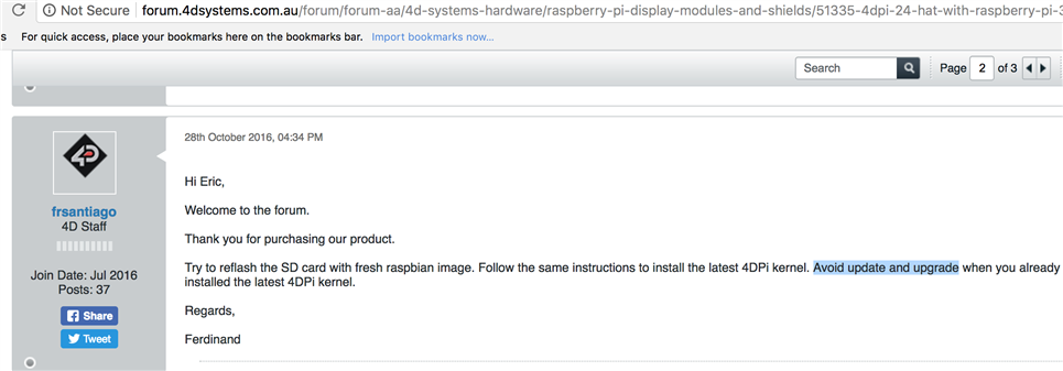

Then I followed this document which spec'd out a different file to download -
http://www.farnell.com/datasheets/2172058.pdf
$wget http://www.4dsystems.com.au/downloads/4 DPi/All/4d-hats_4-4-21_v1.0.tar.gz
sudo tar -xzvf 4d-hats_4-4- 21_v1.0.tar.gz -C /
I had to reformat the SD card with SDFormatter then download and image the latest Raspbian NOOBS image (Insert a two-day delay here)
Then try again with the updated Kernel -
And that failed also...
After two or three more failures, I found that the instructions included in the box, and even the ones available online seem to miss a critical step. Essentially, one must find a forum post from 4D systems to get a Dropbox link to a custom Raspbian image with the drivers pre-installed. And once the custom drivers are installed, DO NOT "sudo apt-get upgrade" since it will brick your Raspberry Pi. Seems like a sketchy as a way ofdoing things with a commercially available product. I bricked my Raspberry about 5-6 times in the process and I really hope to not do it again later since I will have a lot of custom work done. I guess the best thing that happened here is that I spent a lot of time documenting each and every step since I had to re-create it every time.
Here is the link I used to the forum post i eventually found, complete with the dropbox link - 4DPi-24-HAT with Raspberry pi 3 - 4D Systems Forum and a screenshot showing a forum post from 4D telling users NOT to run updates...
The Datasheet from 4D systems - http://www.4dsystems.com.au/productpages/4DPi-24-HAT/downloads/4DPi-24-HAT_datasheet_R_1_10.pdf is the most useful document. It shows that the screen itself is using the SPI interface, and the touchscreen and physical buttons use I2C interface. This will be useful later on as I plan out the physical mapping of components. For instance, the only extension cable I found readily available (from Adafruit - https://www.adafruit.com/product/1337 ) doesn't technically work/fit on the Model 3. After reviewing the schematics, however, this should actually work just fine since the additional IO from the 26 to the 40 pin header is not relevant to the 4D  systems Hat.
However - With all the lost time on this one component, I am not very satisfied. I will put the screen off to the side for the time being and proceed with the rest of the important development and decide later on what to do for the UI.
