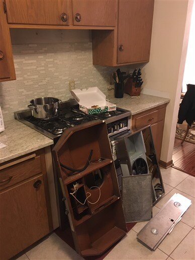

This project will complete our kitchen renovation which still requires a new range hood. The goal is to create a smarter range hood for (hopefully) less than buying an off-the-shelf 40" hood for $1000.
Since the kitchen remodel started back in March of 2017, I have found a new range hood in the scratch & dent area of a home remodeling store - an old display model. I was able to purchase it for $75 and it was originally a $300+ range hood.

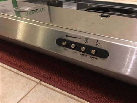

Here we see the kitchen with the new counters, stove, and backsplash. We also can see the old ugly range hood and the new doner hood sitting next to it on the floor. The fan box and most the wiring will be used in the new design, but a smart controller will be added in lieu of the original pushbuttons. A touchscreen interface will be used. The touchscreen will use the same mounting holes as the original pushbottons. The ribbon cable will feed out through the opening. Relays will be used to control the circuits as dictated by the user or the automation.

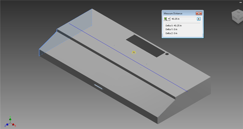

This is a CAD model of the hood that I have 90% designed. New exterior sheet metal will be created, but the guts of the doner hood will be added along with the new controller.

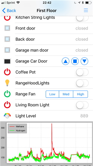

The mockup shown above includes range hood lights, plus fan speed control. Note - this is mocked up inside my existing OpenHAB smarthome. All the other items shown are fully integrated based on Arudion/ ESP8266/RaspberryPi projects. The Methane and Hydrogen levels shown in the graph are readings from two MQ sensors that are placed in my house to monitor gas levels. That project was originally done to look for dirty diapers with my first child.
