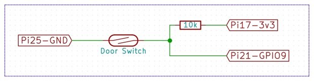

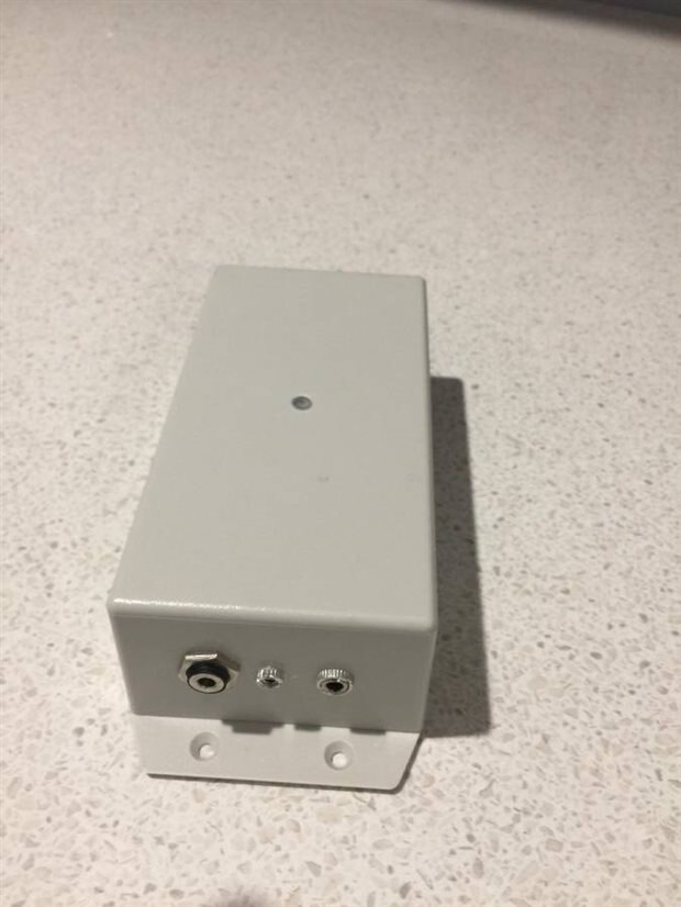

The sensor unit will be based on the Raspberry Pi Zero W, and include a DS18B20 temperature sensor, and after a quick design thought (thanks to others) a magnetic reed switch as a door sensor.
One of the advantages of using the DS18B20 sensor is they are utilise the “One-Wire” protocol and include a unique identification code. This will allow more than one sensor per Raspberry Pi Zero W to for use in Fridge / Freezer type scenarios or colocated cooling appliances (even ambient monitoring)
With that in mind, the only other comment required for the temperature sensor is a 4.7k resistor to go between the Data and Power pin. Only one resistor is required for the whole “One-Wire” network, so then the next sensor is simply connected in parallel.
To allow the operator to know the operation of the sensor, A tri colour LED will be installed showing basic operational states. A 330ohm resistor is connected to both anode pins of the LED.
As suggested by others, I will include the provision for a Magnetic Reed switch. This only requires a 10k resistor to tie the normally open switch pin to keep the pin from “floating” and tie it high.
As I mentioned earlier, I will update or re-blog a more thorough build for the sensor as there is some fun details to be included. But as an interim here is a photo of the completed unit - product labels are hopefully on there way.
