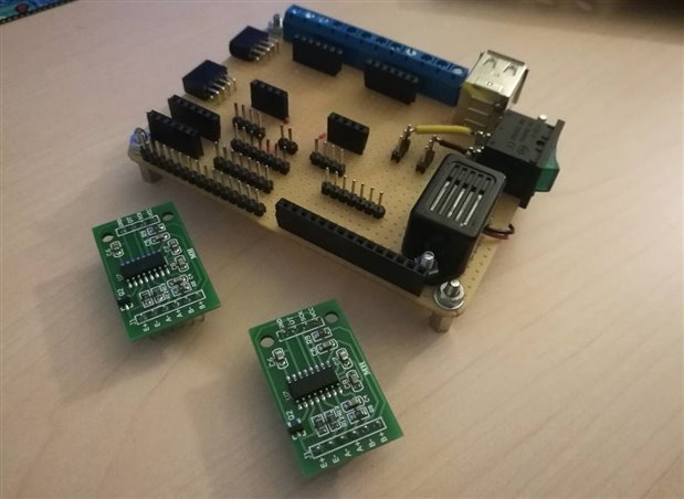

Hi guys, this will be a short update blog, I'll be showing the small board i soldered up for the amplifiers and other stuff that may be needed in the project as well as the way I am using 2 load cells per amplifier. The plan for the full shelf is to use 4 load cells in total, 2 per shelf, as mentioned in the previous blogs one part will be aimed towards lighter stuff like spices and such, while the other one will be for the bigger and bulkier stuff. I can always go with 4 hx711 amplifiers, but that would mean that there will be 4 less GPIO pins available (this may not be that big of a deal in this project, but I want to keep everything to a minimum). The ones I am using are dual channel (as most of those I saw online are, I don't know if all are or if there are single channel ones, I didn't research that), this is how I connected them to the amplifier:
  • E+ and the red wires from both load cells
  • E- and the black wires from both load cells
  • A-  green wire from one of the load cells
  • A+ white wire from the same load cell as A-
  • B- green wire from the other load cell
  • B+ white wire from the same load cell
This of course meant that some changes needed to be made, the library I used was tatobari's hx711 library, about which I talked about in the previous blog (S.H.E.L.F. - The one item shelf - Pi Chef Design Challenge - Blog post #7 ), I made minimal changes to the code to get readings from the other load cell when they are connected like this. Here is how (this is an addition to the last blogs code):
hx2 = HX711(5, 6)
hx2.set_gain(32)
The rest of the code is exactly the same as in the previous blog, just we have to double every command, and also calibrate the second load cell in the same way we did with the first one. For the second part of this update I'll be talking about the small board i soldered up, it is half finished for now, it is missing the underside connections and the power supply jack. With this board I wanted to have a clean way to connect the sensors with the amplifiers as well as have direct power output from the power supply directly rather than from the Raspberry and a power switch. Some of the other thing I did is I left a lot of the pins empty as well as easy to connect to other things to be possible to easily upgrade, the hx711 are easily removable, if I ever need them in a hurry for another project, and there are two USB ports which can be used for Raspberry/Arduino. Here are the pictures of the components as well as of the (half) finished product:
