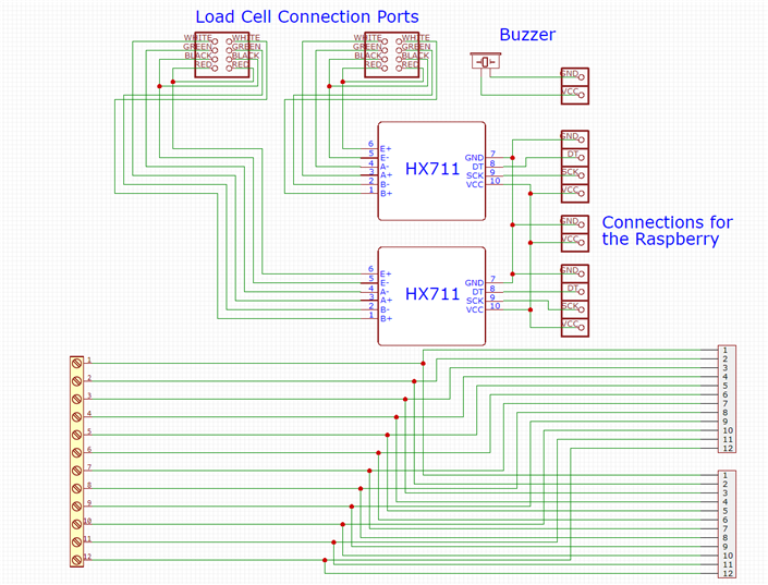

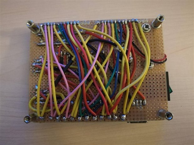

I am in the middle of working on the first prototype, and writing the blog for it, it is taking a while, so I'll just share the progress on the board from the last blog for now(S.H.E.L.F. - Dual load cell and Board - Pi Chef Design Challenge - Blog post #8 ), also I have found an Android app which I managed to easily link to my Raspberry (though I have started the work on that as well) with thingspeak. So here is the main idea behind scheme behind the board I made, without few stuff like the power supply and buzzer (they are just straight connections), the idea is just to have a simple way to connect the sensors to the amplifiers as well as some screw connectors for easier upgradeability.

    genebren over 8 years ago +1
    Short update or not, they are all helpful. Even though your hand wired board is clean, the PCB will be much cleaner. Keep up the good work!
  • milosrasic98
    milosrasic98 over 8 years ago in reply to genebren +1
    Hey Gene, A PCB would be much cleaner for sure, the thing is I don't think I can have it made here in time, so I went with the approach above. Milos
    genebren over 8 years ago in reply to milosrasic98 +1
    Milos, Yes, timing is everything. Turn around time on a PCB is an issue. You proto board is a lot cleaner than a lot of my attempts. Good luck. Gene
