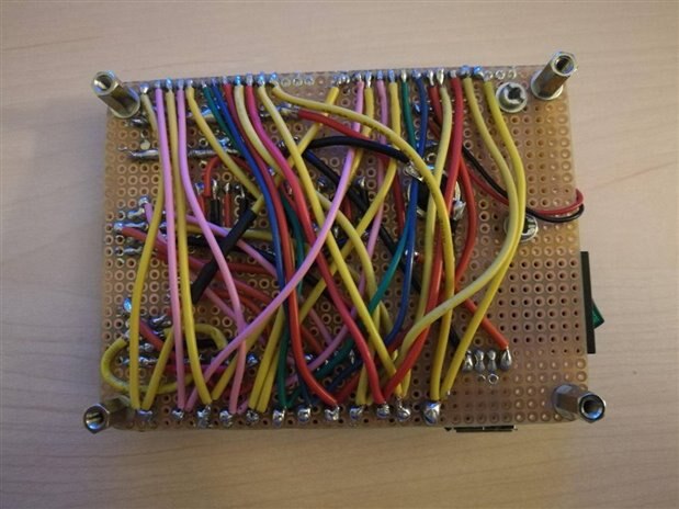

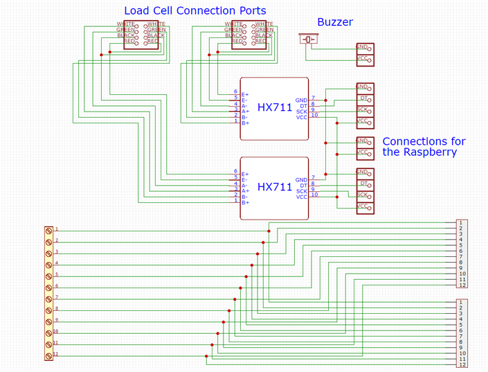

I am in the middle of working on the first prototype, and writing the blog for it, it is taking a while, so I'll just share the progress on the board from the last blog for now(S.H.E.L.F. - Dual load cell and Board - Pi Chef Design Challenge - Blog post #8 ), also I have found an Android app which I managed to easily link to my Raspberry (though I have started the work on that as well) with thingspeak. So here is the main idea behind scheme behind the board I made, without few stuff like the power supply and buzzer (they are just straight connections), the idea is just to have a simple way to connect the sensors to the amplifiers as well as some screw connectors for easier upgradeability.
Sorry for another short update, next one will be more interesting, hope you liked it!
Milos
    genebren over 8 years ago +1
    Short update or not, they are all helpful. Even though your hand wired board is clean, the PCB will be much cleaner. Keep up the good work!
  • milosrasic98
    milosrasic98 over 8 years ago in reply to genebren +1
    Hey Gene, A PCB would be much cleaner for sure, the thing is I don't think I can have it made here in time, so I went with the approach above. Milos
    genebren over 8 years ago in reply to milosrasic98 +1
    Milos, Yes, timing is everything. Turn around time on a PCB is an issue. You proto board is a lot cleaner than a lot of my attempts. Good luck. Gene
