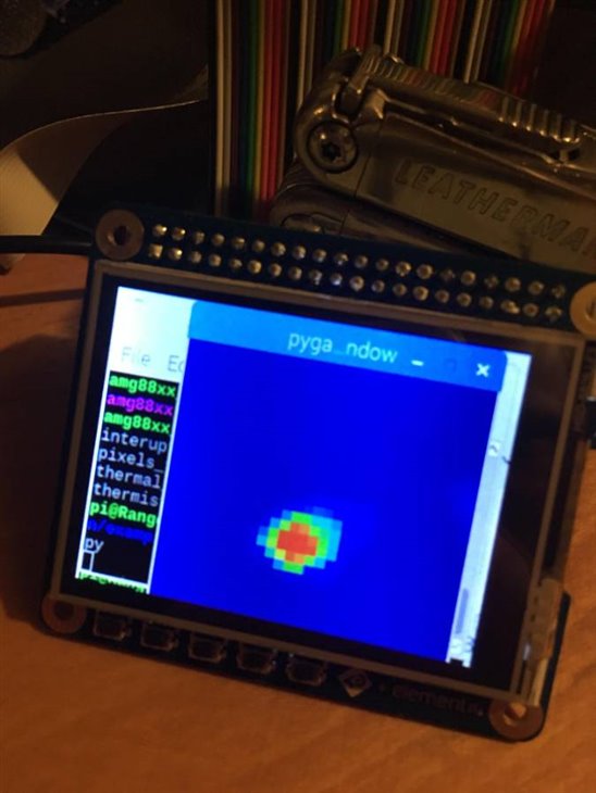

I'm glad you asked! The very first time I got all the components install for the final integration, I started taking images with the thermal camera to integrate the GridEye. While doing so, the exhaust fan automatically clicked on because the methane and LP sensors picked up the small amounts of gas in the air. This actually surprised me since I wasn't really expecting that much "actionable" data from all these sensors; but low an behold things actually worked. Once I integrated the GridEye sensor, I had loads of temperature data for the Range Hood and I was able to easily run the fan when the stove was on.
So yes, it works very well! It works better than I imagined it would!

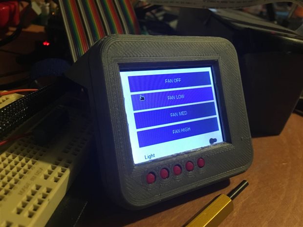

The touchscreen inside the 3D printed enclosure before I blow'd it up.

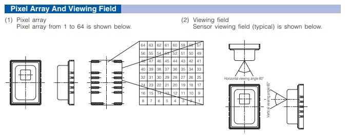

Stretch goal - Actual integration with the Grid Eye
I wasn't expecting to have time to do much more than just take nice pictures; but I was able to do some good integration.

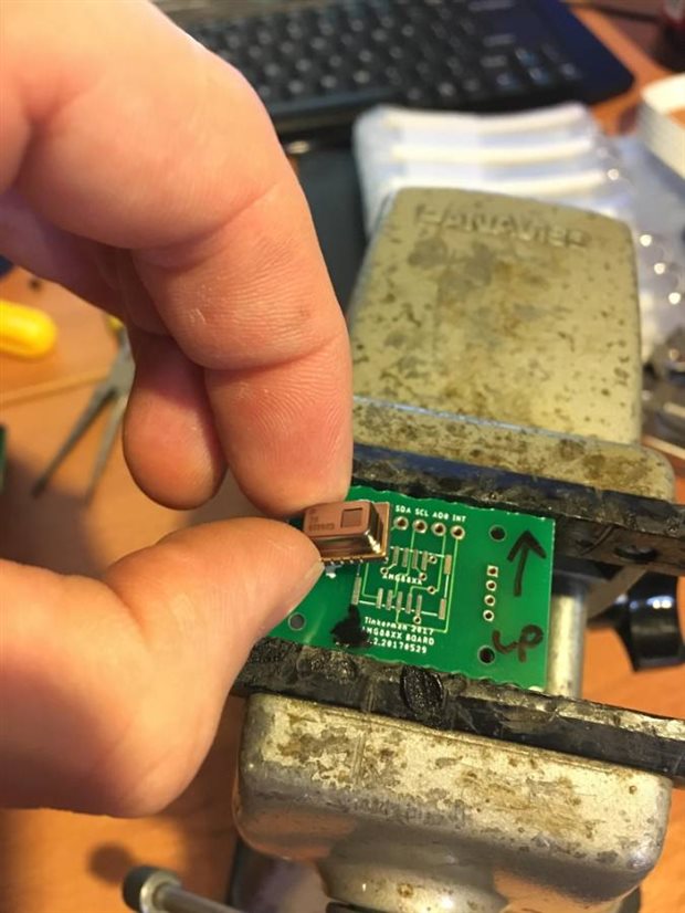

I started with a base GridEye from Adafruit. Back in blog post #3 I mentioned that the base GridEye had a limited sensing range of 20-80 C. A comment noted that a different version of the sensor has a higher sensing range. I was able to get the stand-alone surface-mount sensor from Newark and I found a PCB layout available online to utilize it. I gave myself about a 20-30% chance of this all working. I've never done surface-mount soldering before (although I've been around people who do it quite a bit). I ordered up the PCBs piggy-backed to my other boards back in Blog Post #9.

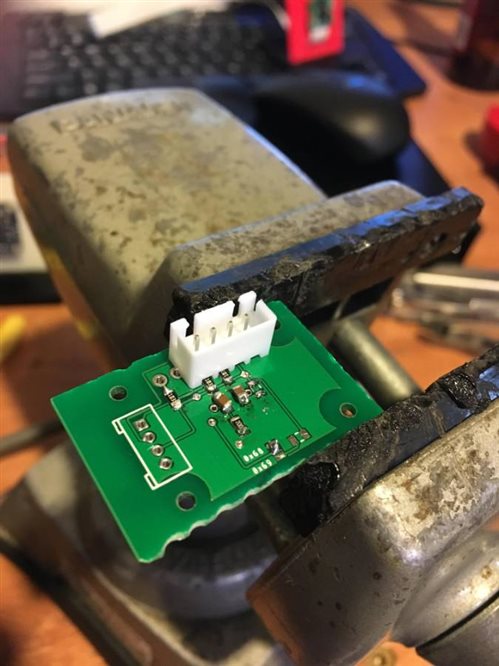

I cut the boards apart when they arrived and went for it! Essentially what I had to do was prepare the solder pads for the sensor by melting solder on them without the sensor. Once all the pads had solder, I placed the sensor and heated all the pads on one side by running the iron back and forth across them. Once the solder turned molten, the sensor 'sank' down into place. Then I quickly repeated the process on the second side. I did have to slide the sensor around a bit to get correct alignment, and I took it off a few times to try over. I was worried that I may have sank too much heat into the sensor at one point since it got very hot. The datasheet notes exactly how much heat is 'safe' and I may have exceeded it in my rush to get this done.
Getting ready to solder the sensor on the board - wish me luck!
Back of the board with SMD resistors and caps. The address bit is the little solder pads bottom center. This board had .1" spacing header and JST 2mm spacing.
I threw a header on the PCB and the rest of the little 0805 resistors and caps and crossed my fingers. The first power up didn't work and I realized I had crimped one wire on the jacket missing the copper core. I eventually got it to respond and I could see it on the I2C bus; but the Adafruit library was failing to pull images from it. After some further investigation, I realized that the library must not have been able to talk properly since the new GridEye was addressed 0x68 instead of 0x69 which the Adafruit comes with. I switched the solder pads to the other address and viola! Images!

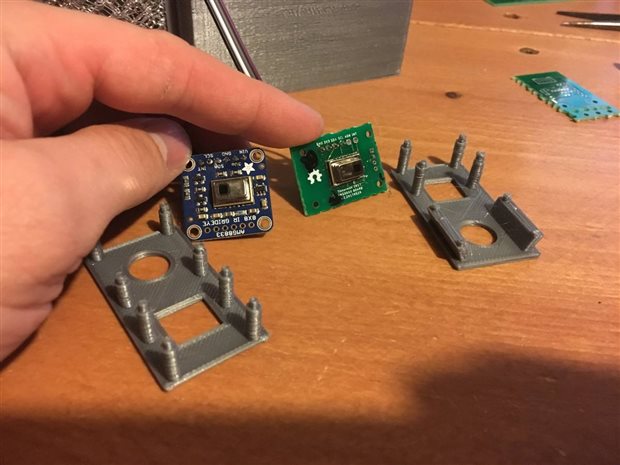

I then just updated my Air Baffle mount for the new hole pattern and went ahead with integration.
Old and new cameras with mounts for the air baffle
I used the Adafruit library to take images and they display them in the NodeRed dashboard.
Reading the temperature data was a little more involved. The GridEye has 64 individual sensors ("pixels") which each read out a two-byte temperature measurement. That means 128 bytes of data; however this is a limitation on the I2C bus of 32 bytes. I tried reading all 128 at once and the Pi basically just locked up. I decided that the next best was was read 32 bytes of data at a time and save them to a global array.They I can just use the complete global array from within NodeRed to get my data.
Translating the bytes into degrees F required a few steps - I first read in an array of 32 bytes; representing 16 "pixels". To combine the two bytes into a single number, I bitshift 8 bits to the left and combine the two with a bitwise OR. The binary number uses "two's compliment" which means that the first bit in the sequence is the positive/negative indicator. The sensor has a resolution of .25 degree C (and an accuracy rating of +/- 3 deg C), so I divide the number by four to obtain the degrees C. Then that is converted into F and saved out to the global array.

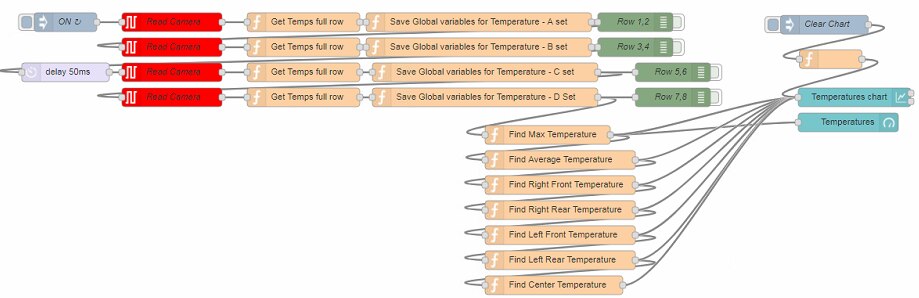

Read 32 bytes; bitshift 8-byte array, then to C, then to F. ("Get Temps full row")

And here is the Node-Red flow.

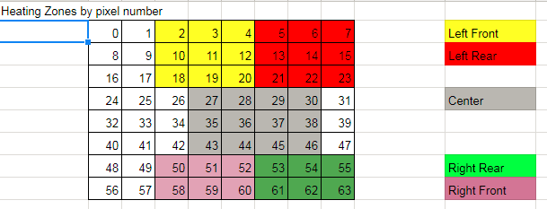

Once I have the global array, the rest become trivial. I calculate an average temperature and find the MAX and write them out. I also calculate a temperature for each of the individual burners by doing an average of certain pixels based on their location under the camera as follows -
Note - my sensor orientation is such that the left side of the grid above is the front edge of the stove and the right edge is the rear of the stove.
Here is how I read the temperature in the left-front zone on the stove:
var avg = 0;
avg = avg += parseInt(global.get("RangeTemperature[" + 2 + "]"));
avg = avg += parseInt(global.get("RangeTemperature[" + 3 + "]"));
avg = avg += parseInt(global.get("RangeTemperature[" + 4 + "]"));
avg = avg += parseInt(global.get("RangeTemperature[" + 10 + "]"));
avg = avg += parseInt(global.get("RangeTemperature[" + 11 + "]"));
avg = avg += parseInt(global.get("RangeTemperature[" + 12 + "]"));
avg = avg += parseInt(global.get("RangeTemperature[" + 18 + "]"));
avg = avg += parseInt(global.get("RangeTemperature[" + 19 + "]"));
avg = avg += parseInt(global.get("RangeTemperature[" + 20 + "]"));
avg = (avg / 9).toFixed(2);
return {payload: avg, topic: "LF"};
- Just average all the pixels in the array which cover that section of the stove top.

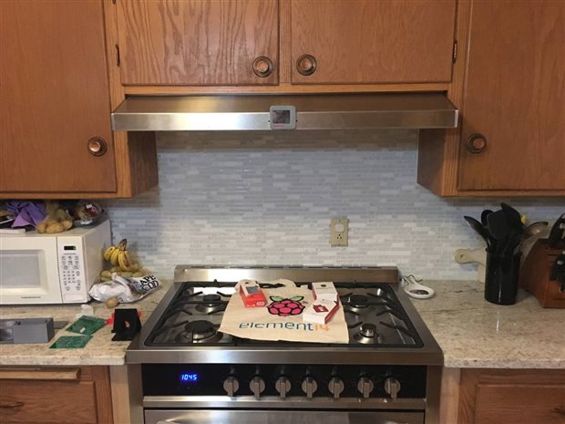

And finally, presenting the final product!!!
(Note: a new touchscreen will be installed on Friday when I get back from my trip; but the UI is the same as the mobile view)
