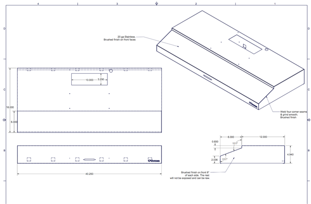

I have completed my mechanical design for the range hood. This will consist of two pieces of sheet metal bent up by a local fabricator to meet my specifications. For many reasons, this feels like a major hurdle that I have crossed since it has been such a long time in the works.
This took many hours of measuring, remeasuring, remeasuring again, then all the CAD work - I spent a lot of time trying to get the "contour flange" to work properly in order for the front panel to lay out properly. Many hours of trying, reading tutorials, doing lessons, and watching videos on YouTube were required to achieve this finished portion of the project. I know that most the focus of this Newark Design Challenge will be related to the electrical architecture, controls, and wiring, but for my project the sheet metal represents a significant portion. This is doubly true since the goal will include the fact that this is a permanent fixture in our house and will outlive our tenure here - I need to make it good enough that when we sell our house it can stay. Granted that the RaspberryPi will be removed and the normal controls will be replaced; but the rest will be here for a long time to come. If for any reason the new hood can't arrive and be integrated in time, the doner hood will be used as a substitute. I can validate all features through using it as a stand-in.

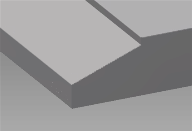

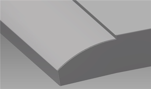

Most of what was done in Inventor started with a very basic sketch. They say if you're drawing more than rectangles and circles, you're over-thinking things. I started with a rectangle which was 40.25" x 12". Then I used the "flange" tool which makes a bend in the sheet metal, and dictated that it be ~5" tall to create the rear panel. Then another flange was created on one end of the rectangle for the right side of the hood. The process continued of creating flanges and bending the part usually at 90 degrees and that got me through most of the design process. I created the bolt patterns using a "point" then creating a "hole" with them. This allows precise placement, and the hole feature allows many useful features such as counterbores and chamfers.
I spent a lot of time in this design process thinking about how to make the sheet metal easy to manufacture. I am only planning to make a single piece, so want the fabricator to be able to easily create it. I need to know that they probably won't make a lot of money on a job like this, and if they make any mistakes and have to start over then they will likely lose money. If I was creating this commercially I could think about it much differently - the fabricator would probably make a nice jig and the could afford to waste a few pieces here and there across the 1000's or more units they build.
Probably very difficult to make "one" copy of:
Probably much easier to make "one" copy of:

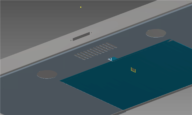

Another area I spent a lot of time on is relative to the placement of the sensors - I officially have the following which require being able to "sense" the range top - GridEye IR sensor, Raspberry Pi 8mp camera, DHT22 Temperature/Humidity sensor, and a total of four "MQ" air sensors.
I was considering using a replaceable panel on the insert which could have custom holes or a 3D printed section to hold the sensors. I later changed this to just some slots. This would be quite incognito for the current iteration as it will hide all the sensors; plus later on wouldn't look strange when this becomes a normal "dumb" range hood.

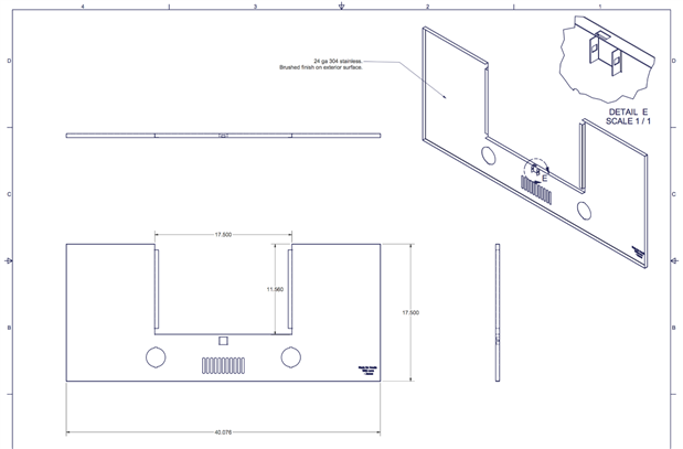

Here are the final components - I have attached the .iam, .ipt, .pdf, .stp, and .stl files for all of this to the post (archive.zip). If you want anything else, please let me know. I sent the PDFs and also created a .dxf file for the manufacturer. The PDFs attached to this post show all the major dims of this component.
