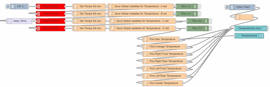

One thing which can be noted in blog post #7 is how the UI wasn't reporting the spike in humidity as I breath on the sensor. The system reacts properly by activating the fans, but the UI never responds with the current reading. The code at that time was a simple "rate limit" node which only passes a reading after a given time period. This was the "quick and dirty" way of getting the system running, but was not the most elegant way. The algorithm itself is constantly polling the sensors (10 times/second in other applications I've done) but we can't just throw all this data into a UI or log in a database since /those/ use cases are more "long term trends" and "big changes". What I've done with Arduino in the past was to code out a special type of rate limit - only pass data every X minutes unless the process variable exceeds N threshold versus the previously reported value. This is the magic key to keep the algorithm running full speed, keep long term data without wasting space or overhead, and still be able to capture fast moving variables which are masked by the reporting window. This is somewhat related to the Nyquist theorem - be sure you can read the data fast enough for all use cases. I wasn't sure what the best was of doing this would be in Node Red, so I was leaving this part until later in the project so I could focus on more major parts of the project.
This image shows how the GridEye /was/ being read - we inject a timestamp every X seconds; read out the sensor, the find the temperatures as seven individual datapoints. The problem with this was that the Temperatures Chart was getting 7 updates every X seconds and trying to refresh the UI. A high read rate makes the algorithm responsive but crushes the UI. A slow read rate helps the UI to be responsive, but kills the responsiveness of the algorithm.

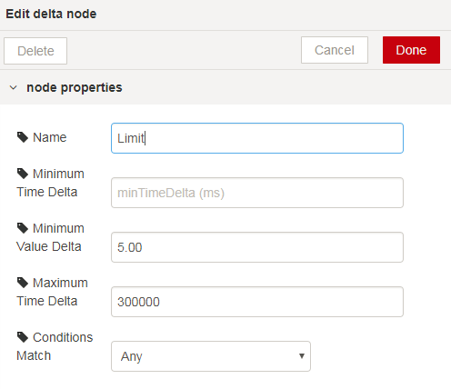

What I found was the there is a built-in function which does basically this exact thing - the Delta Node. This keeps track of the timestamp and data payload of the previous packet which it allowed through. Here are the settings I used for the Max Temperature Delta node:

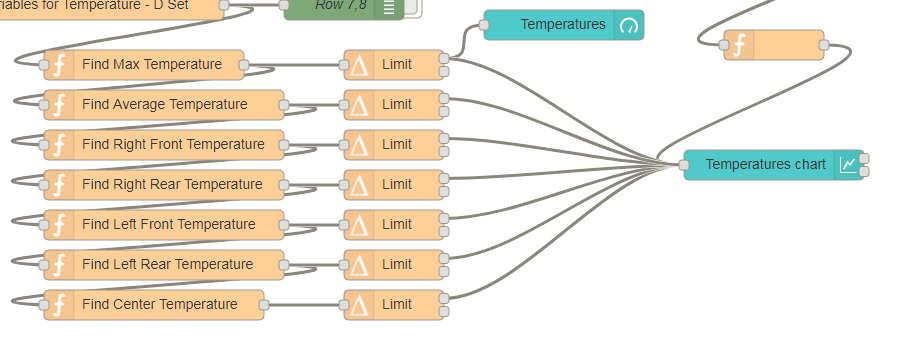

This passes a single payload every five minutes regardless of it numerical value. It also will pass a payload and resets the timer if the incoming payload is more than 5.00 [degrees] different than the previously passed value. The /more/ final flow is shown below.
This simple change then allows the best of both worlds - I can crank up the read time on all the sensors so the system is responsive; and the UI will stay responsive since it isn't getting flooded with updates. I added the Delta node on to all the sensor flows where they report either to the MQTT broker or push data into the Dashboard.
