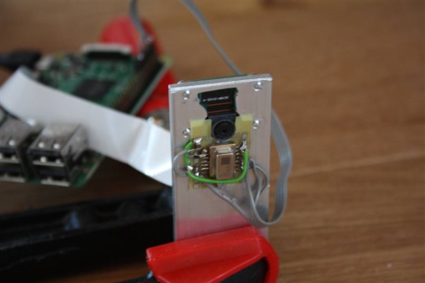

Camera mount
As I already mentioned last week I manufactured a camera mount, where the Raspberry Pi camera and the Panasonic Grid-Eye sensor are mounted close together. Here is again the foto of the installation:
The idea was to overlay the image of the camera and the temperature sensor to 1. get an image with temperature information which is very nice to view and to 2. get information how good the sensors are aligned.
Matching the images together
The grid-eye sensor has an viewing angle of 60 degrees in both directions and the Raspberry Pi Camera Module v2 has a field of view of horizontal 62.2 degrees and vertical 48.8 degrees. So horizontal it should match quite well (with little tolerance) but vertical the grid-eye sensor can see more than the camera. The grid-eye sensor has a aspect ration of 1:1 and the camera has one of 4:3. This is no big deal: I will add some black fields at the top and bottom of the camera and the data matches.
Here is an image of the combined output:

Unfortunatelly OpenCV and the video input buffer always add a little delay to the video stream. So there is a little delay between the temperature data and the video. One solution would be to handle the video input in a second thread. But this is more complex so I have to live with this little delay for now.
What's next?
In the next days I will mount the sensor combination atop of my cook top and do some test measurements.
