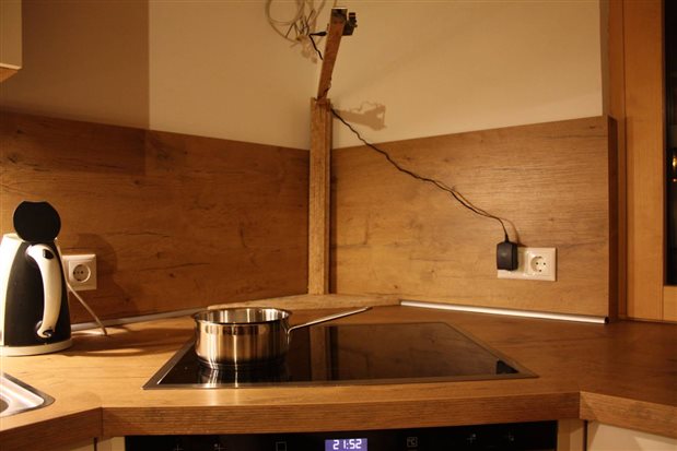

Today I made a better camera mount and did more tests.
Camera mount

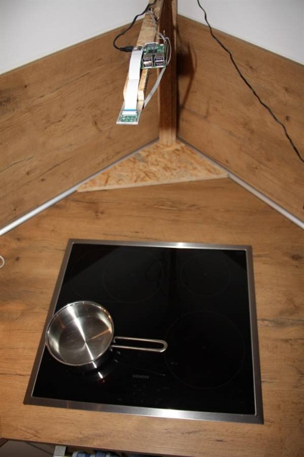

To get compareable results I need to place camera and temperature sensor always on the same spot above the cooktop. So I took a few wooden planks and made a new mounting arm for Raspberry Pi and camera. It places the camera 60 cm above the center of the cooktop.
Here is a photo from the front:
And here is a photo from top so you can imagine what the sensor sees:
The sensor is placed where normally the range hood sits. Maybe I should team up with aspork42 to get sensor and firmware into his Smart Range Hood - Pi Chef Challenge Blog post #1
