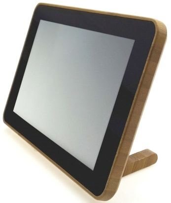

The Pi 3 and touch screen are going in a bamboo chassis - I thought it was appropriate for a kitchen:

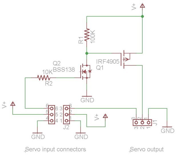

The next item on the menu was the servo drive circuit - we can't have an element14 design project without a circuit design.
Most of the electronics are purchased modules, and fortuitously the Voice Hat has servo drivers on it. However one thing about servo motors is they can consume power when stationary and they can also sit there buzzing away hunting for a specific position. The Spice of Pi mechanisms will not move if power is removed from the servo motors, so I want to make a circuit that allows power to the servos to be turned off when they are not needed. To do this, I want to use extra servo channels as digital outputs to power switches. Connector wise I will use 2 adjacent channels where the second channel is just controlling power to the first channel. The circuit is pretty simple - a logic level N-channel FET will turn a P-channel power FET on or off. This allows the power FET to control power at a higher voltage than the Raspberry Pi supply. The power FET has a built -in diode that will snub any motor power spikes. The cute part about the design is it will allow 2 servo motors to plug into these power & servo control cards which in turn plug seamlessly into the voice hat without interfering with each other or anything else.
I need to send this out for manufacture right away as it is already going to be in a race with Chinese New Year - which will freeze all manufacturing activity in its tracks and backlog all shipping activity.
Here is what the circuit looks like so far:
The power switch is serious overkill - capable of switching 74 amps, but they are cheap and I can get them. They have 0.02 ohms on resistance - I have pieces of wire with higher resistance.
Next I will work on the carousel design. I have worked out which spice jars I will be using (spice jar prices can be shocking) and have figured out how the jars will sit in the platter. I have ordered and received quite a few parts - not sure yet if I have enough parts, but the design is taking shape.

    dougw over 8 years ago in reply to DAB
    Good point. The PCBs come in batches of 10 so I will have some left over for future projects. The footprint is generic, lower current FETs will fit on the card as well.
