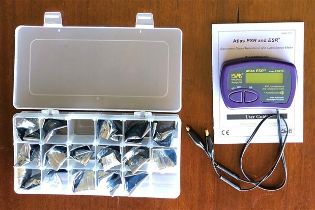

The element14 Kit
The Panasonic polymer capacitors in the element14 kit came nicely packaged in their own compartmentalized box.  They are all surface mount.  It is nice to have the assortment as it gives a good idea of the size and range of what is available.
My first impression of the Atlas Peak ESR70 is good.  It seems well made and is easy to use.

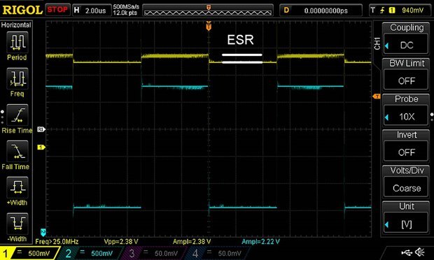

The method for measuring ESR with an oscilloscope is shown in the following diagram:
The square wave generator is modeled as an ideal square wave with a resistor Rout in series.  The capacitor is modeled as an ideal capacitor with a resistor R in series.  Voltage is measured with an oscilloscope.
In summary, if the frequency of the square wave is in the 100 kHz range an ideal capacitor begins to approximate a short circuit for the values of capacitance we are interested in.  However, a real capacitor has some equivalent series resistance (ESR) that will cause a voltage drop across the capacitor which can be observed with an oscilloscope.  The method is instructive in that the comparison between ideal and real capacitor behavior can be intuitively grasped from the oscilloscope display.

The square wave generator will be modeled as an ideal voltage source with an output resistor. It is necessary to have a known output resistance in order to set up a resistor voltage divider so that the ESR value can be determined.  The square wave will be generated by an AD9850 with an added resistor to make the divider.  There is a description of the AD9850 module and the microcontroller being used here.  Normally a function generator with known output resistance is used and if the proposed method fails a function generator will be obtained.
The ESR can be calculated with the resistor voltage divider equation:
     Vr = Vfg (R / (R + Rout))
Where  Vr      =  Measured voltage across capacitor due to ESR (measured)
            Vfg     = Function generator voltage (measured)
            R        = ESR
            Rout   = output resistance on function generator (known)
Rearranging, and solving for ESR we get the equation shown in the diagram.
        Vr (R + Rout) = R (Vfg)
Vr (R) + Vr (Rout)  = R (Vfg)
              Vr  (Rout) = R (Vfg – Vr)
                            R = Vr (Rout) / (Vfg – Vr)       formula (1)

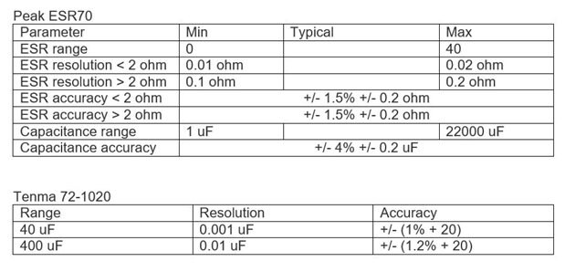

The Peak ESR70 will be used to confirm the results from the oscilloscope / function generator experiments.  It will also be used to confirm capacitance measurements from a good quality bench multimeter.  Tests will be run at room temperature, approximately 20 degrees C.  ESR-70 capacitance probes will be calibrated before starting.  The function generator square wave (100 kHz, ~3V3) and resistor divider settings will be set before starting.  The following procedure will then be followed for each capacitor:
Measure capacitance and ESR with ESR70
  1. Measure and record ESR
  2. Measure and record capacitance
Measure capacitance use of Tenma 72-102072-1020
  1. Measure and record capacitance
Measure voltages with Rigol DS1054Z and Ultrascope
  1. Measure and record open circuit voltage Vfg on oscilloscope
  2. Put the capacitor being tested in place as shown in the diagram
  3. Measure and record voltage across capacitor (ESR)
  4. Look for exponential rise / fall due to RC charge / discharge as shown in diagram and other anomalies.  Record with screenshot.

Discussion of Error
None of the instruments being used have calibration certificates and all, with the exception of the ESR70, have been in use for more than a year.  Some pertinent specifications from the instrument manufacturers are given below.
Testing methods and termination used for ESR measurement with the oscilloscope could introduce error.  The ESR model used is relatively simple and inductance / parallel resistance is not accounted for.  Accordingly, accuracy and resolution for the oscilloscope method has not been determined.

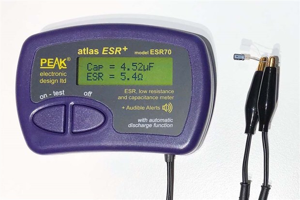

Shown below, the Peak ESR70 measuring a 4.7 uF aluminum electrolytic....
The same 4.7 uF aluminum electrolytic being driven with a 100 kHz square wave is now viewed on the oscilloscope.  The lower blue trace is the square wave and the upper yellow trace shows the voltage drop across the capacitor (ESR) as indicated by the two white lines drawn in and labelled.
The methodology is still being worked but the calculated ESR is roughly 7 ohms with the oscilloscope method and 5.4 ohms with the Peak ESR70.  It probably will  not be possible to measure very low ESR with the oscilloscope.
