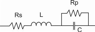

Physical capacitors have both resistance and inductance in addition to capacitance. The capacitance usually dominates,but the other parameters will affect performance.
Here is an equivalent schematic for any physical capacitor:
Usually the parallel leakage resistance (Rp) is very high and a little tricky to measure, but often it is so high it is negligible.
The inductance is usually very small and only plays a role at very high frequency or very high slew rates, so it is also usually negligible.
The series resistance (Rs) is the parameter that some technologies cannot get to be negligible. It can significantly affect capacitor performance when dealing with high frequency, high current noise. It is importance to understand which capacitor technologies have low ESR (equivalent series resistance) and which have high ESR, so it doesn't become a problem in any given circuit design. Polymer capacitors typically have a nice low ESR.

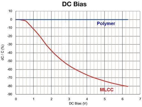

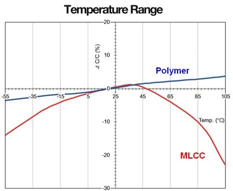

Here are a couple of graphs that highlight advantages of polymer capacitors over MLCC capacitors:
This graph shows that polymer capacitors do not suffer as badly as MLCC capacitors at either high or low temperatures.
This graph shows that polymer capacitors have constant capacitance over their rated voltage range while MLCC capacitance falls as the voltage is increased.

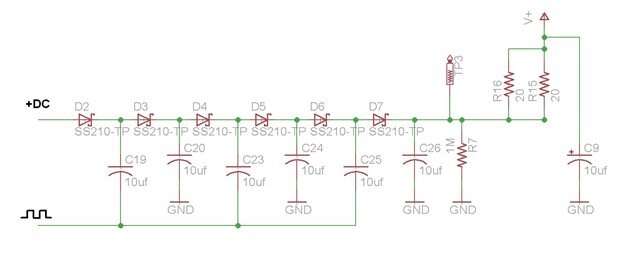

To test this I have designed a charge pump circuit as shown below:
With a 12  volt input the output of the charge pump should be close to 48 volts - with no load.

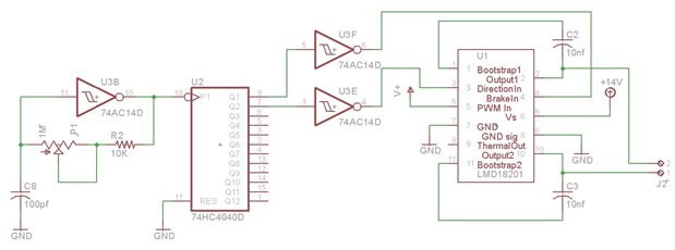

To drive this charge pump I designed a simple power oscillator:
I will only use one of the outputs from this H-bridge driver as the capacitors are polarized and the full bridge would reverse polarity.
I will make one charge pump with MLCC capacitors and one with polymer capacitors.
I think I will connect one output to each charge pump so I can monitor both circuits at the same time on the scope.

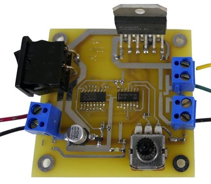

Here is what the oscillator looks like:
It uses an LMD18201 which is a 3 Amp H-Bridge.
Note the potentiometer which can adjust the frequency between 20 KHz and 1 MHz.

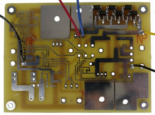

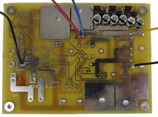

Here is what the MLCC charge pump looks like:
There is some extra circuitry on the card, such as a low voltage power oscillator and a high voltage output oscillator, which are not populated because I don't have the right parts in stock.
Here is what the polymer charge pump looks like:
It is a tight fit to install the polymer capacitors since the card was designed for 1206 footprints, but since there is no solder mask, there are enough traces in the right places and the spacing is just adequate.
I had measured the spacing before making the proposal for this project, but he spacing turned out even tighter than expected.

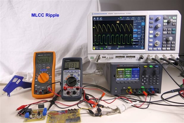

The Charge Pump Performance Tests
Here is a video comparing polymer capacitor charge pump performance versus an MLCC charge pump:
I discovered later that the glue gun heater resistance starts at 500 ohms when cold, then drops to 200 ohms as it heats up, but as it get even hotter the resistance climbs back to 350 ohms.

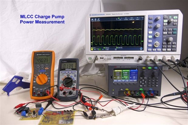

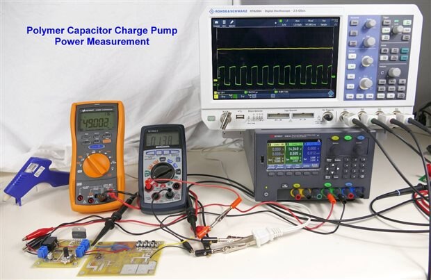

In the following 2 pictures I added a current meter on the output, instead of trying to measure the heater resistance, so I could get a power measurement.
As you would expect when the output voltage is the same, the output power is the same, but the input power is not the same.

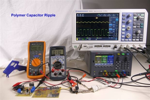

Ripple Voltage
The following 2 images show the ripple voltages of the 2 circuits:
ParameterMLCCPolymer Capacitor
Output Voltage (V)4949
Input Voltage (V)1614.05
Input Current (A).5720.565
Output Current (A)0.1390.138
Input Power (W)9.157.94
Output Power (W)6.826.76
Efficiency (%)74.585.2
Ripple Voltage (Vp-p)2.910.5

  • At 49 volts output with a glue gun heater load, the input power was 7.94 W and the output power was 6.76 W, providing an efficiency of 85.2%.
For the MLC capacitor charge pump:
  • At 49 volts output with a glue gun heater load, the input power was 9.15 W and the output power was 6.82 W, providing an efficiency of 74.5%.
This means the polymer capacitor circuit requires 11% less power to generate the same output power.
To achieve 49 volts out, the MLCC circuit needed 2 more volts at the input which is a 13% increase in input voltage.
The output ripple voltage with the MLCC circuit is about 5 times higher than the polymer capacitor circuit, which could be important if this were used as a power supply.
With the same input voltage (12V) the polymer capacitor circuit generated about 6 more volts (under load) than the MLCC circuit, which is about 17% higher.
