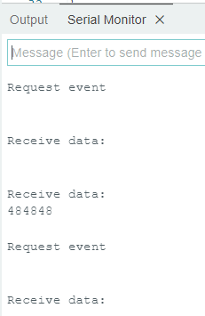

2. MKR 1310 received message from I2C master as Fig 4: data package was 484848(in Decimal), which is ASCII code for b'000.
Fig 4: MKR1310 as I2C Slave Received Data from I2C Master
