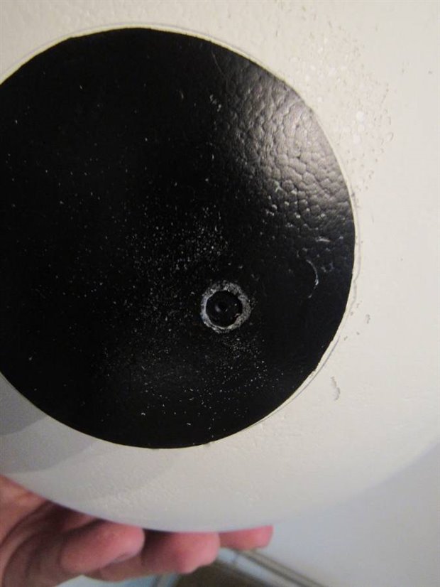

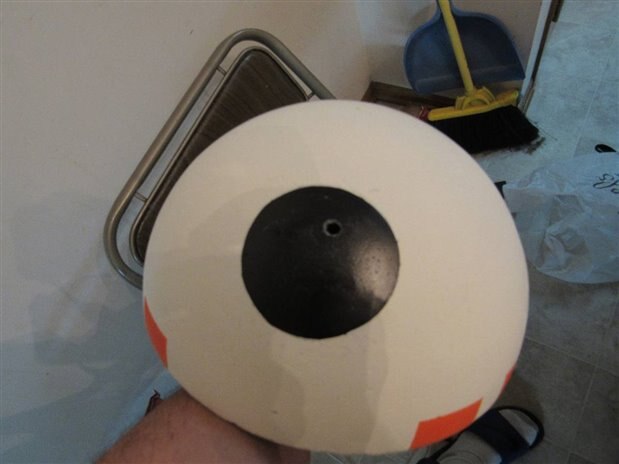

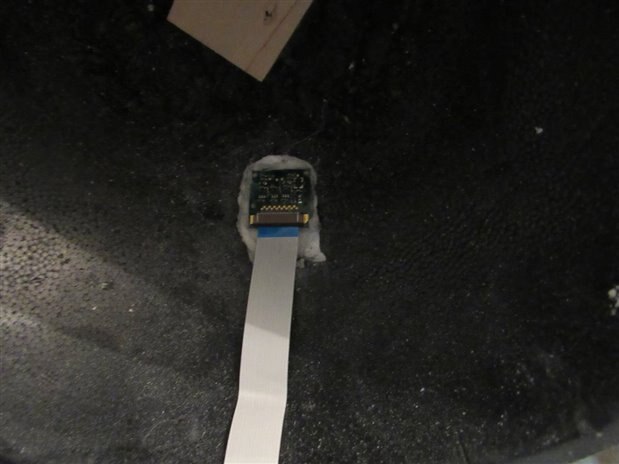

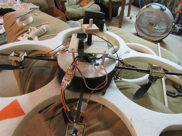

I have mounted the camera in the head, and have the head moving!  I don't have the servo secure yet so that is why it is wobbly.  I posted a vid below on a preview of how it works.  I just controlled it with my radio but in flight the Raspberry Pi (RPFS) will use it to "Scan" around.
Cut a hole for they eye
Pi camera mounted with hot glue
lens pokes through
Servo, needs hard wood mounts, just held on with glue for now.
A preview.  Note the plastic eye cover, made from a Christmas Ornament.
